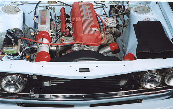

I guess I could be wrong but the only pic I have is that of a KAe with modified top feed......
