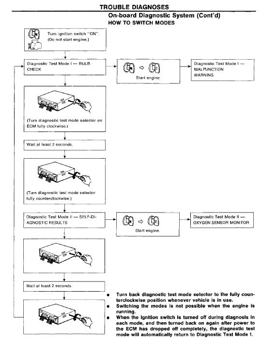

If reseting the ecu did not work, try ecu diagnostics test. when you follow the test info notice the led light and how many times it flashes( flashes twice fast means 2, flashes 4 times slow is 4 this means code 24 and so on) if you need the code meanings look in the FSM or ask me and i will give them to you. here is how to do the test.
