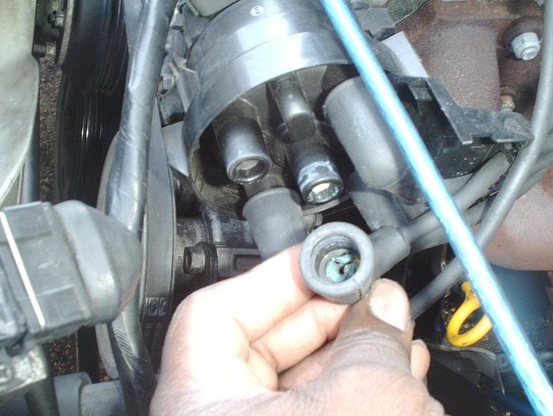

Well, I finally figured out why my car has been dying on me during driving. I put a new fuel pump in today thinking that would fix my problem. I finished installing the pump. I could hear it prime when I turned the ignition, my old pump was not priming. I started the car and ran it for 10 minutes then turned it off and started it again and nothing. I was pissed. Not because I bought a new fuel pump, I really needed a new one anyway. I was mad because I thought I had solved my problem but to no avail. I got under the hood and started checking everything. I went to the ignition coil and checked it...nothing. Then I pulled the distributor cap and started pulling spark plug wires. I got to the middle spark plug wire and found this to my amazement

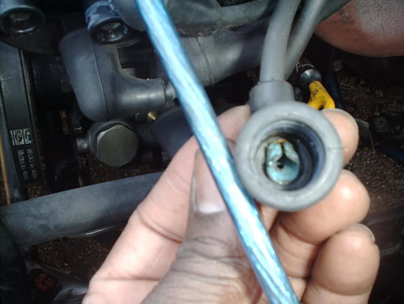

The wire was pushed back, turned on it's side and it had some blue residue built up around it and so did the distibutor cap where it was plugged.
It was obvious that this wire hadn't been plugged into the distro for quite some time. I immediately realized that this was my problem! I cleaned it up, straightened the wire and plugged it in. My car fired up time after time. My problem has been fixed. What a dumb@$$! yes!
