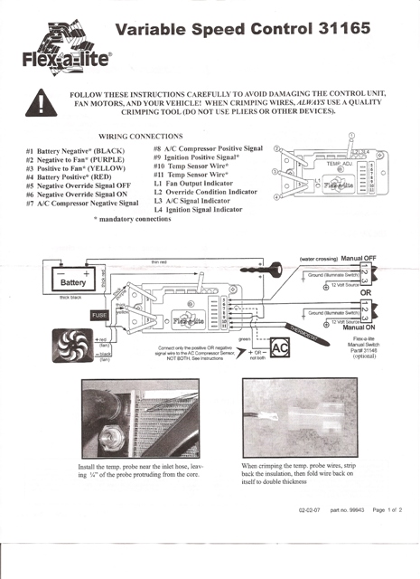

Just one more quick question. (got the switch and a fan-set from a Altima)
What is the best source for #9? I'd usually run to something like the coil +, but with the integrated cap and coil, I don't want to play with that part of the harness, you know?

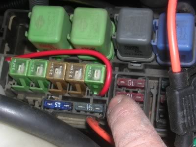

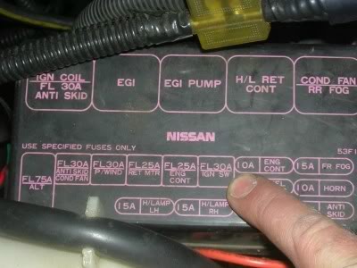

This is one of the most common questions that I am asked all the time. You are looking for the ignition signal. The coil would be a bad choice as it can delay the coil to fire or not start the car at all. You would want to run through the relay box on the passenger side of the car. It is closest to the radiator, and right next to the battery. On the box there is a fuse labeled ignition, or ignition switch this is the 30AMP source that you need to tap into. Make sure to run an inline fuse off of the 30AMP fuse as well, if not you could possibly overload the circuit if you ever chose to run other devices off of it.
