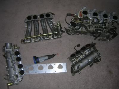

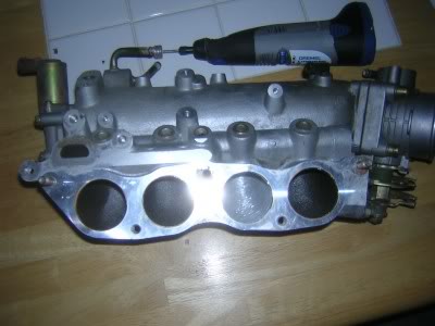

Old May 10, 2007 | 08:35 PM
BigVinnie's Avatar
Posts: 2,502
From: Walnut Creek
Originally Posted by re037
cool thnx! time to budget a rebuild project in august...
Don't forget on the budget build you need to get a dremel... Heres a sneak peak of what I am talking about...Soon to be the another sticky thread.
