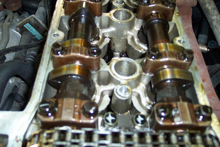

Is this TDC??
Is this the cam position when the pistion is TDC??
(It just finished the intake stroke..)

lol, i simply wanted to verify that that is the postion if the cams when the cylinder #1 is at TDC

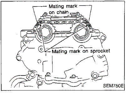

heres the fsm pic from the 96, should be the same for all ka24de...i would think, hope this helps
