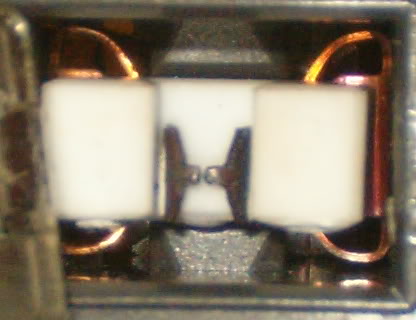

where was the fuse at? Becasuse its the same deal for me, my clock always says 1:00 pm everytime i start the car.. and if i turn the key to the on position nothing happens also.. its so weird, is it a 90 240? someone else on this forums besides us had the problem also!
here tell me if this is bad, i assume it is but i was 100% proof that it is.. any maybe that will have been my problem also!
but it makes perfect sence, because the fuse being split in the middle, when you send a big enough voltage through it it will make the gap and once electricity is present, the current will continue to flow, but if its broken, when you turn it to its ACC position the current is not great enough to breach the gap..
heres my pics
sorry for the poor quality it was in 5x digital zoom to focus on that small object!
heres my pics
