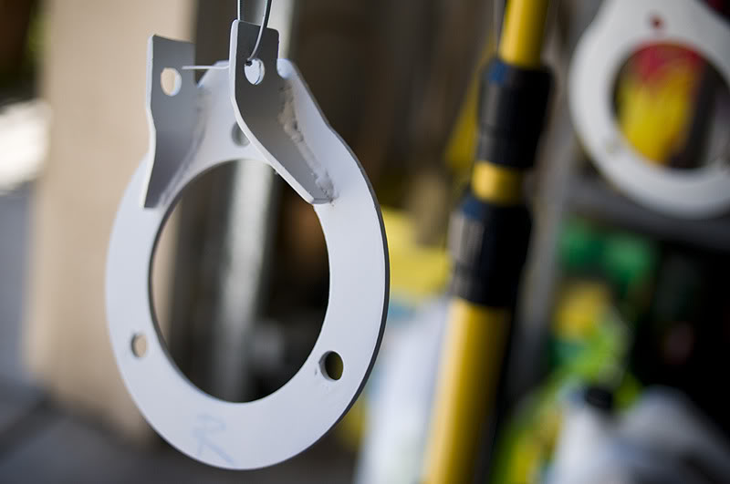

I've wanted a strut bar forever, dude. It looks cool. That's all. But nothing fits an s12, nothing within reach at least. I think an R31 bar fits. Anyway, I love the Cusco bars, except that if I were to order one, I wouldn't be able to realign the mounts since their mounting plates are made of aluminum(I can't weld that stuff). So I just got a cusco style bar with steel brackets off ebay for $60 shipped, not too shabby right?
The bar is supposed to fit BOTH s13 and s14, so there's a few slight problems. I already have to cut the mounts off the plates and realign them to fit the s12 anyway, so it won't be too bad.

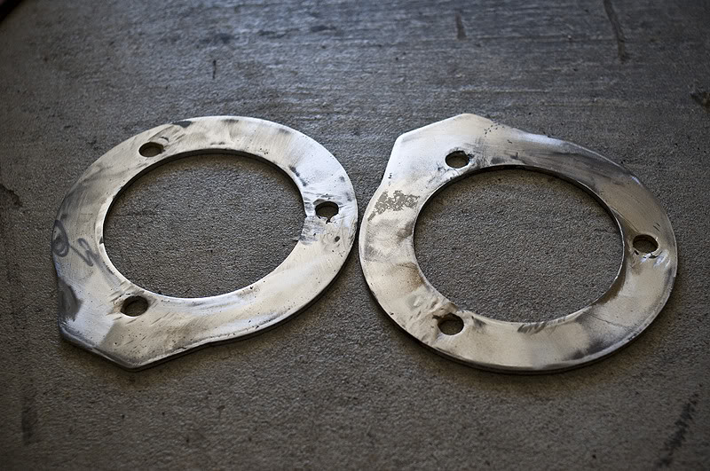

ALL the holes are ovaled out for the s13/s14 universal fitment, I will fill these in

brackets cut off and the oval holes are filled in

more oval hole filling comparo
I wore a pretty serious face mask when I sanded off the paint. chinese lead paint destroys families
all ovals filled in

new hardware that fits

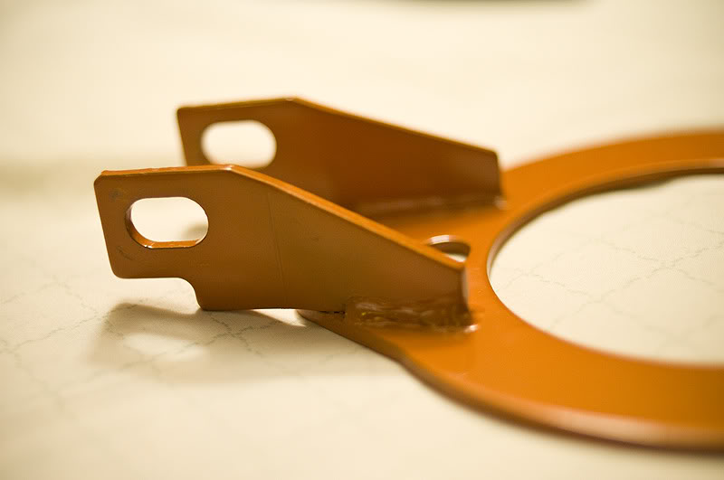

tacked in, you can see the sockets on top of the bolts to protect the threads from splatter
compared to the pics of it new, you can see how much I've pushed the brackets in and bent them accordingly. the nuts on the innermost bolt is super barely able to come off, so it worked out

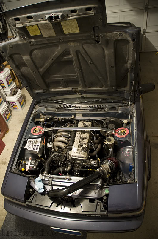

hood mod too

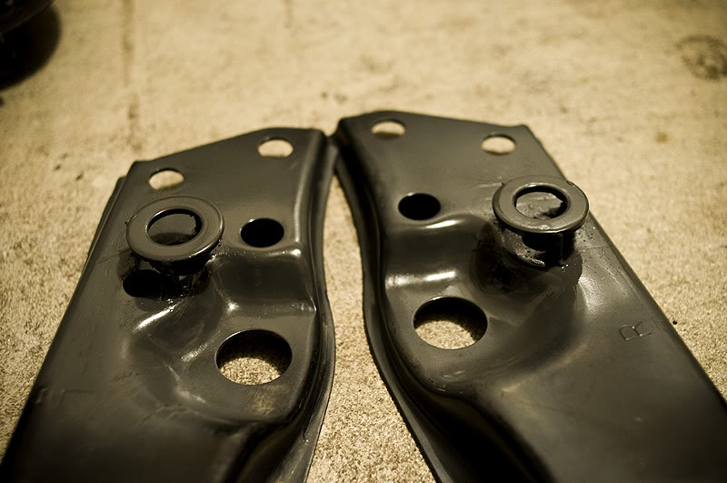

and new bottom rad mounts!

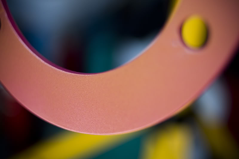

pink with copper sparkle!

and welded on washers for the lower radiator mount, seats the bushings perfectly and the rad is placed level against the support

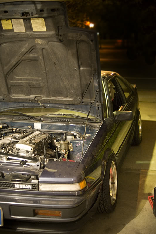

And this hood mod keeps getting more convenient, letting me work under my garage ceiling light
