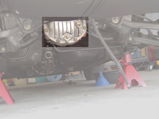

There is another thing to look for is the diff cover. Non lsd open diffs will have a flat face while VLSDs have fins.

Take a look at the cover on the rear of the punkin. See if there are horizontal fins on it. Those are cooling fins. They will tell you if you have vlsd. Or you can let me drive your car. If both wheels smoke as I pull away you will be happy.

Oh yeah here are the fins I keep talking about:
What am I looking for? This sounds like an easier way to check if the 240sx I will be purchasing have LSD or not.

The area that is not shaded is your differencial cover. The lines you see work the same as the heat syncs on your cpu.
I don't have a picture of a open diff but this is what you are looking for.
