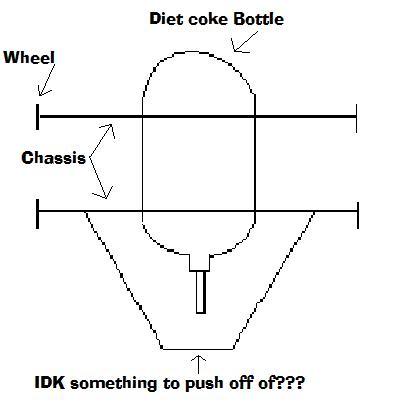

I just got my 1st project for my engineering class......Yes i am a college student. And I am VERY excited about this. Cause I get to use my knowledge about cars in it. But more brains combined is better then one
Rules (as far as I know right now)
I need to make a Diet Coke and Mentos powered vehicle.. I think i have to use 2 litres of Diet coke. 50 dollar budget!!!
I have a basic design and idea in my head right now. but more minds and more ideas help a lot!
What I'm thinking right now is. a 2 litre's of coke is a good amount of weight for it's size... So the lighter the better. Also the size of the spout of a 2 litre bottle is really large... and lets all the gases out quickly. so I need to size it down, for it to last longer. But not to small, think about a exhaust on a car.. To big loose TQ to small loose HP.. Also I think about how big the tires should be and how far away from the bottle the should be. Another thing is what is it going to push off of? Air is pretty thin compared to the gases coming out of the bottle.. and idk if it'll have enough thrust to get going and keep going with the weight.
Here's a crude "paint" drawing of what is in my head
still need to think of a way to keep the bottle to not move....
ANY suggestions helps... if other people think its dumb. who cares, this is brain storming. This isn't due till the end of the semester. But its competition at the end, and I'd really like to win

i remember seeing this **** in 8th grade science. you HAVE to use gas to propel it? wound rubber bands work better. if you have the gas pushing on that back piece, it wouldnt go anywhere. you should make a wheel with a pinwheel type apparatus mounted to it so the air pushes against the pinwheel, and propels those wheels. keep the front wheels hella smooth and moderate size so they roll fast. the more 2 liters, the more drive wheels, the faster. 50 bucks will get you a butt load

the bottle (which is a 1 litre) is pointed towards the ground.... Why would u do that? If i just layed it flat, I dont think the air would make it move. But it's tilted so it hits the ground... Thus making something to push off of. Which is why i put that one part on the chassis. Not only is it something to first push off of, but it stays with the chassis to keep pushing off of. I'm just saying that's what I'm thinking right now. I might be wrong with it tho... If u can come up with a reason why that would work. I'll be on ur side with the idea 100%
On eveyone else's idea. Its a good idea of thinking making something else power the "car". But with many different things trying to take the power from the bottle not only adds weight but it takes power away from the it. Get what I'm saying? Say like u are compressed air trying to push a fan... 7/9 of that air will hit it (guess guessing). So I lose 2/7 of power. Not only that but from what I've learned with cars it'll lose more power after that. Think about a flywheel HP and a to the wheels HP. big difference. I'm not saying ya'll have bad idea's... they are really good. Espically neville i see what ur saying.
