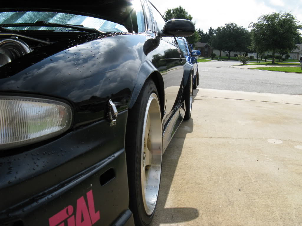

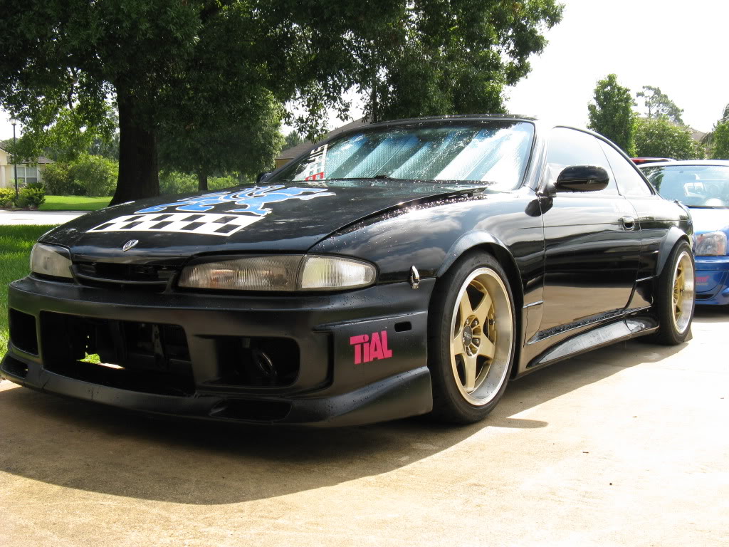

well guys, a small update...
got my H&R extended studs on the front, with the 11mm spacers... now i can have my front wheels on with more that 3.5 threads of meat on the lug nuts!!! YAY!!! i also put my 8mm spacers on the rear, i had em laying around, figured I'd bring the back out a little bit, even though they cleared the coils...
H&R extended lugs, with Gorilla Lug Nuts... hopefully i wont need these soon as i'm getting a pair of Z32 Megan front sleeves for my coils that will bring the shock tube in 2in, and then i can remove the spacers all together... and sit nice and flush... i hate how they stick out past the outer edge of the fender...
wheel's on, lugs nice and tight!!!
finished shot, sorry for the dirty cars and wheels, it's been raining for 2 weeks, almost non stop..
i need to put the 11mm on the back, and have no spacers on the front, then all wheels should sit pretty much flush to the outer edge of the fender.... but they sit fine enough for me right now.... at least until i get some wider proper fitting tires... but I'm working with what little i got...
even with the +30 offsets, i can't complain for $600!!!!! **** still looks great!!

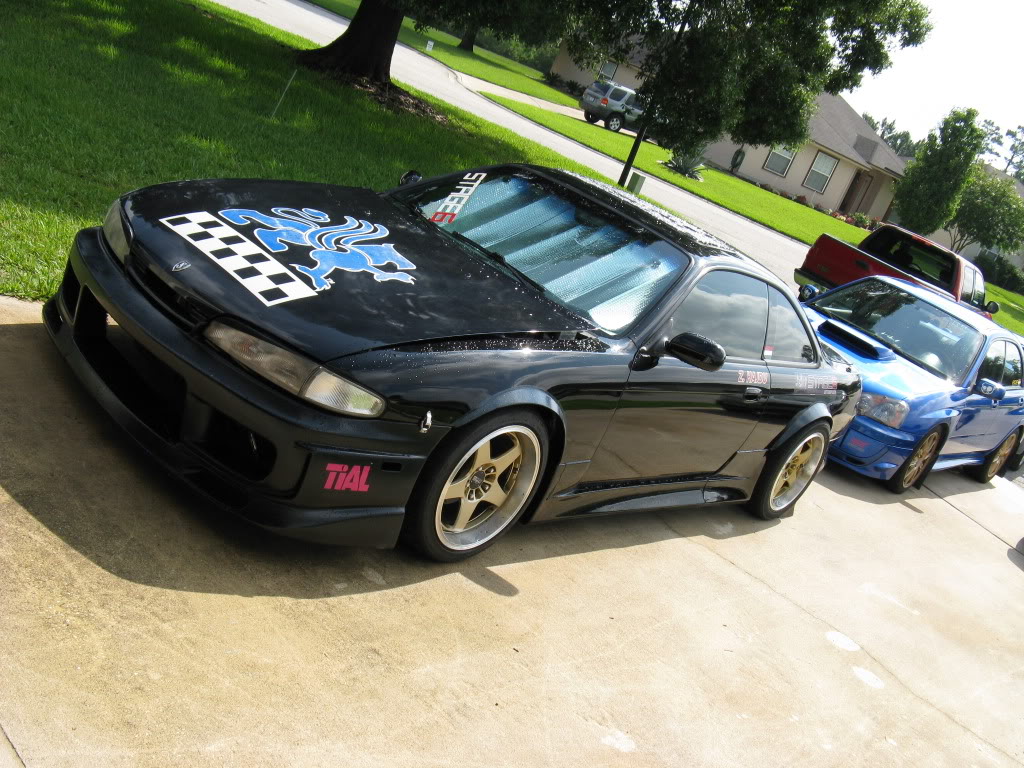

VLSD is in.... car's washed, and lightly detailed....
finally DONE!!!!!!
FMIC lined up pretty good... better than in the gold car... UGH...gold zenki fail lol

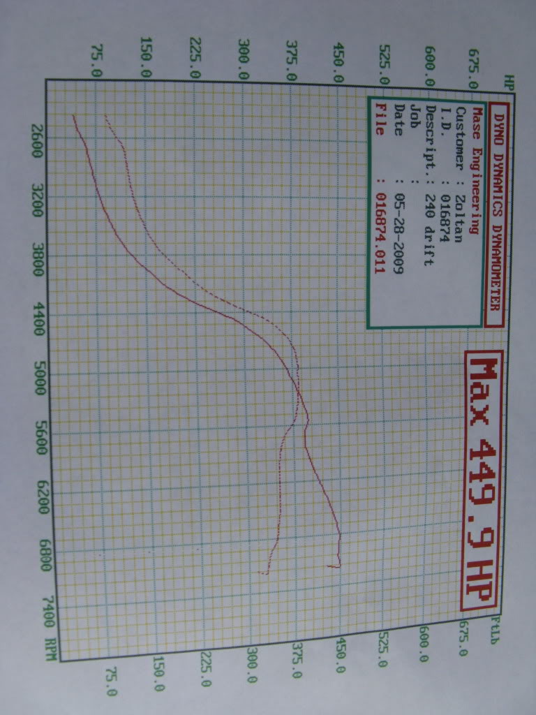

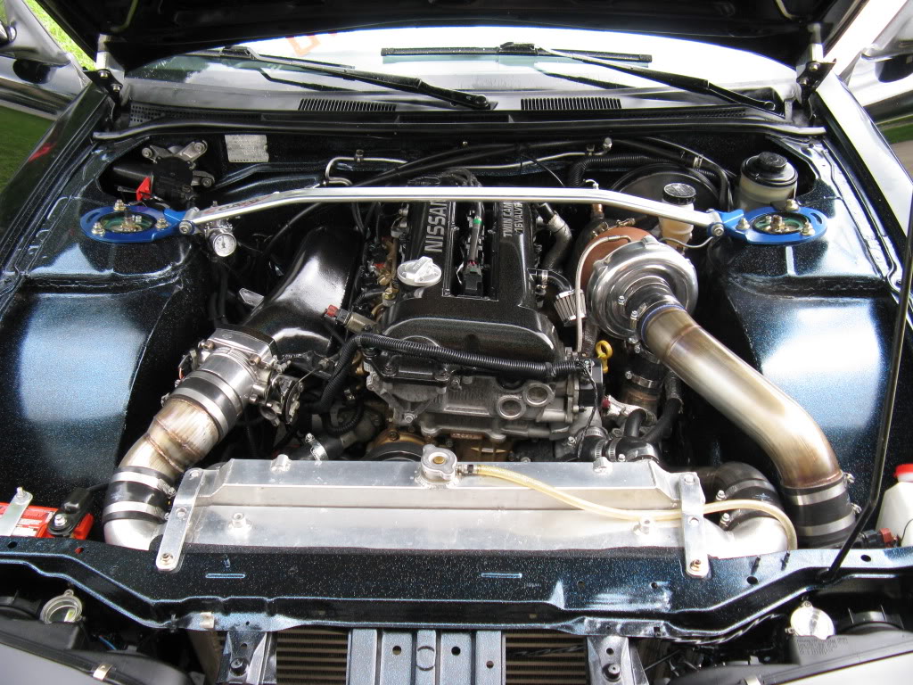

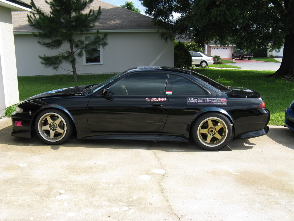

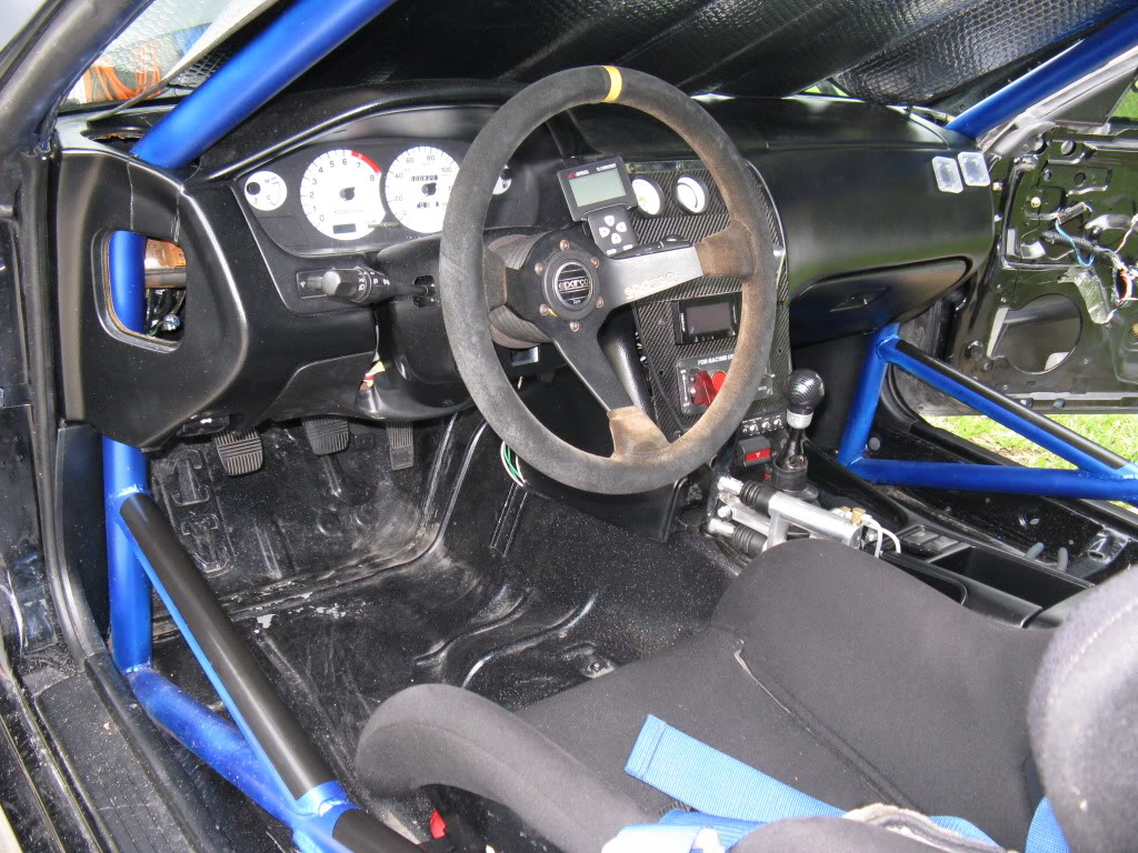

holy crap guys.... i just saw what the guy who bought my first black zenki with the aero has done with it....
it went from this....
then i wrecked it...
then sold the shell to Zoli, a D1 driver... and this is what he's done with it...
needless to say, i want my car back LOL...
just thought you guys who followed my little build thread on that car might have been interested to see where and how it ended up...

i like how he stacked the rad and the fmic piggy backed. is that something popular to do? is there a reason for it other than possibly easier to mount/ you dont have to drill holes in your car?

as for the stacked rad and FMIC... i dunno why... space reasons? less chance on damage? i wouldn't like it as the heat of the rad always on the FMIC would kinda negate the purpose i would think...

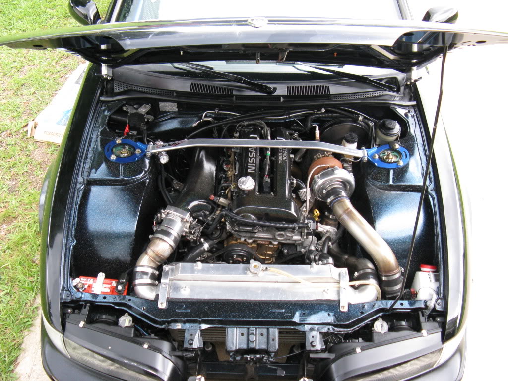

took the S14 and it's SR out for it's first road day since the swap (only minor up and down road trips)... and didn't make it home.... drove into work just fine, lunch break boostin'... then on the way home... it's starts bucking, and bogging... OH NOES... home is 18 miles away, interstate... i have no idea what the prob is... but here's the symtoms if anyone can help me figure it out...
power steering hose, one of em, exploded the other day... that was fun, anyways, it prob sprayed all over the filter... this is just some backround info that might be helpful...
okay... driving down the road, it's like i'm hitting a fuel cut randomly... missing or something, idle is rough, and sometimes smooth, then give it gas, and it acts like it's missing.. car runs and drives, cranks up like normal, but has those symptoms... now, it's a bit more agressive than it sounds... as if my motor is dieing as i'm driving, but then comes back, dies, comes back stays smooth, then bucks/bogs...
i removed the air filter, thinking it may be clogged with PS fluid, and the engine acted like it wanted to die... then idled back up to normal...put the filter on and it surged...
during normal driving, the -hG should be around -10ish, give or take load... while cruising now, it sits at -21 and between -13 and -15 @ idle....
i'm leaning towards fauly MAF, but the ECU isn't throwing any trouble codes... i'm going to try and solve the problem with my 600CC injectors and Z32 MAF.. maybe that will help, i don't know....
it sucks having my baby parked in a wal mart parking lot over night... this will be the second night she'll be there... i may try to nurse her home, but i'm afraid of causing more damage...
could a stuck/seized turbo cause a problem like this?
