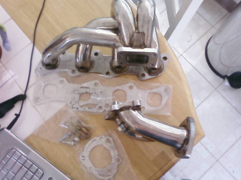

Originally Posted by BigVinnie
Dude If you are going through the trouble of mutilating a header, You might as well port, extrude, hone the stock cast iron exhaust manifold, and add a magna flow high flow 3" CAT.
Or even better buy a turbo exhaust manifold "Bottom mount" to but the 3" CAT too. It would be the same thing as an OBD2 stock exhaust, accept "BETTER".
