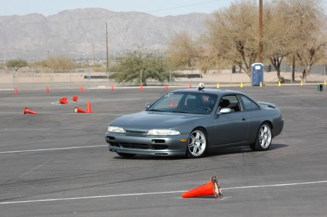

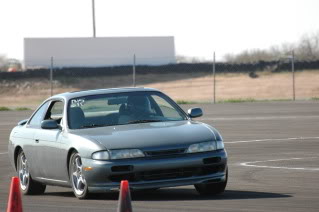

On a happy note, the new springs are definitely an improvement, I went from 340# front, #250 rear to 450# front, 340# rear. the car responses much better and feels tighter and has less roll, you can even see it in the pictures:
Old spring rates:
New stiffer spring rates:

Do you have the spacers on in that one?
Nice time decrease, sucks about the timers...

Thanks dude, and ya the 15mm spacers are now on, I'll take a pic of them next time I'm out in the garage
