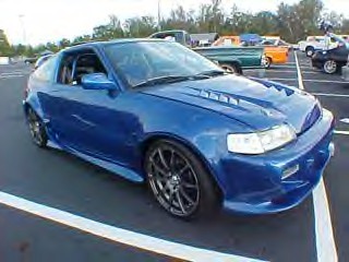

me and my dad did our own paintjob on out crx it actually turned out pretty good we got a basic 30 gallon compressor, gravity fed spray gun, alot of sandpaper and time, some primer, activator, base paint, and clear coat (you can get the paint from house of kolor or local automotive paint store),prepsol, a home made paint booth out of plastic tarp in our garage, a neighbor from wyotech and some patience we just sanded all the paint off the car did all the body work primered it wet sanded the coat of primer then went around the whole car with a rag with some prepsol (to prevent fish eyeing) and then went over it again with a tac rag, laid the activator, a few coats of base coat let it settle for a while then laid a few coats of clear, not sure if this was much help but just a quick run down on how we did it heres some pics

Looks like a good paint job for a DYI job. How much was it in the end? And how many days? or weeks?

in the end probly around 700-800 but we had to buy alot of ondo and sandpaper cause we molded the kit and molded fender flares so that cost like a extra 100 or so just for sandpaper and bondo and for all the paint suppiles around $450 and the plastic tarp was free my dad got it at work the paint gun we borrowed and the air compressor was like $275 i believe but it was worth it but if ur not doin extensive body work and got a air compressor ur lookin at like $600-700 with all the body work it took 4 months the first time we won one show and took the windows back out and started over again fun lol
