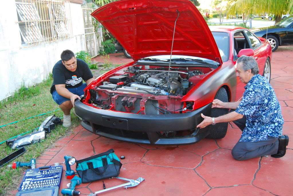

i cut part of the bumper support off for not it bent pretty bad where the accident was anyway im just gona buy the kouki one later
my grandpa helping me put my bumper back on lol

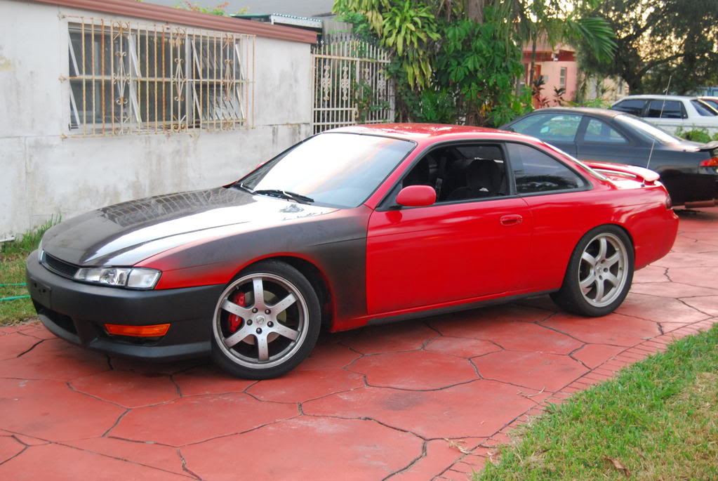

all back together finally i got turn signals lol (even though people dont use them in miami....)

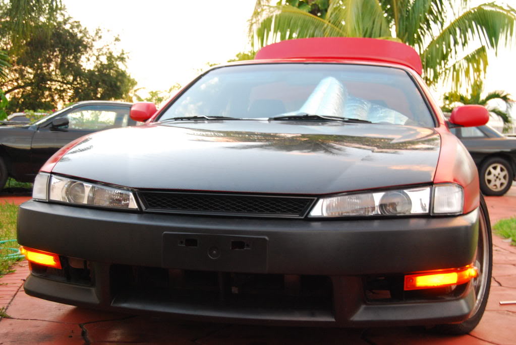

side shot

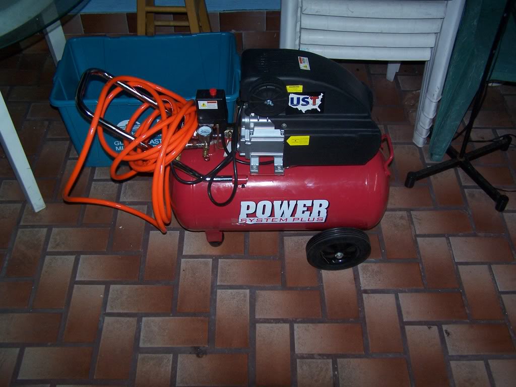

pics and specs on the new air compressor plz
Old Dec 9, 2007 | 08:59 PM
  #231
not an expensive one it was like $100 10gallon 2hp electric motor. it works ok ive only used it to cut somthing it took a while cause i cut a bit then i had to wait for it to fill up again but for small stuff like taking off wheels or taking off flywheel bolts its fine.
but since the cutting wheel need to be constantly on and spinning to cut it takes alot of air so the 10 gall tank wouldnt last long. im deff gona use it to bolt my trany back on.

You can always get a larger... cheap... one at a pawn shop!

Or find another compressor with a blown motor, cap off the top, add a quick dis-connect to it, run a line from that compressor tank to the other one, and use it for a larger resivoir!
I have a 30 gal belt driven at home, and a 22 gal with a blown motor as my resivoir tank. i can shoot a whole coat of clear without it cycling on. Everyone knows that when a compressor runs, its hard to keep stable psi.
