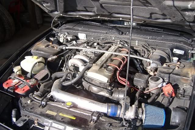

Here's my beloved KA24DE
Here is what is left. About to be pulled next weekend.

lol. ur KA is a mess with all its vacuum lines and worthless emissions devices. Get rid of all that shiat on the CA.

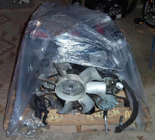

I finally got in some wrench time with the ca18det as I begin planning goals for the install. This is my first engine swap, and as I stand at ground zero in my planning stage, I figure I would give my first impression on what I’ve got myself into.
I bought this motor solely because it was the most affordable high revving, turbo, JDM motor I could get my hands on in the shortest amount of time. Its here, it’s on a palette, and waiting for me to get it installed and running.

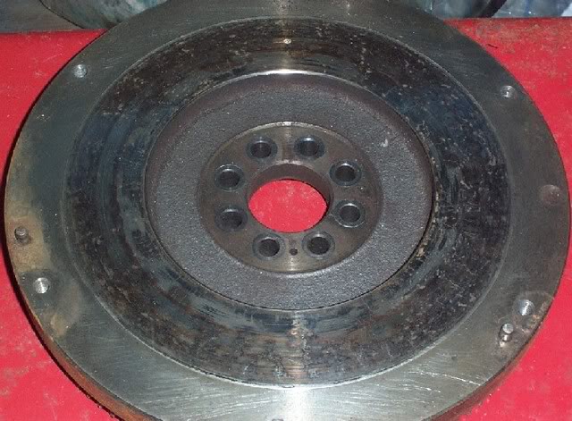

I began the clutch replacement, and noticed that the flywheel has heat cracks throughout it. I have a local company who can hopefully resurface it. If not, the best I can find for replacement are lighten flywheels that start at $300

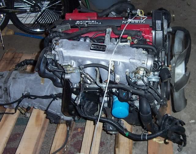

I didn’t realize that the ca motor doesn’t operate with a distributor or spark plug wires. The motor is equipped with a coil pack for each spark plug. I hope they are functional; I priced out replacement coils at $87 a piece.
I think everything else can be worked out when the motor is in the car. I guess that is it for now. Just rambaling on here… I’ll add to this as I go
Coil pack
Flywheel before resurface
Coil pack

hmm goodluck, i would think a resurface should work fine so long as it hasnt been resurfaced to many times already..and yea that wear does look weird..
sr uses coilpacks as well, jus thought id add that incase u didnt know

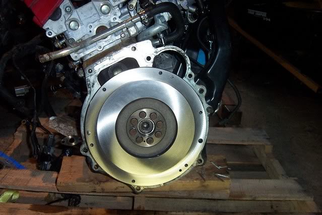

Installed the newly resurfaced flywheel.
I planned to get the clutch replacement finished, but the pressure plate did not bolt up to the flywheel. It was said that a ka clutch would mount up to the ca flywheel, but it was completely different pattern. I need to take a closer look to verify I received the correct clutch kit.
