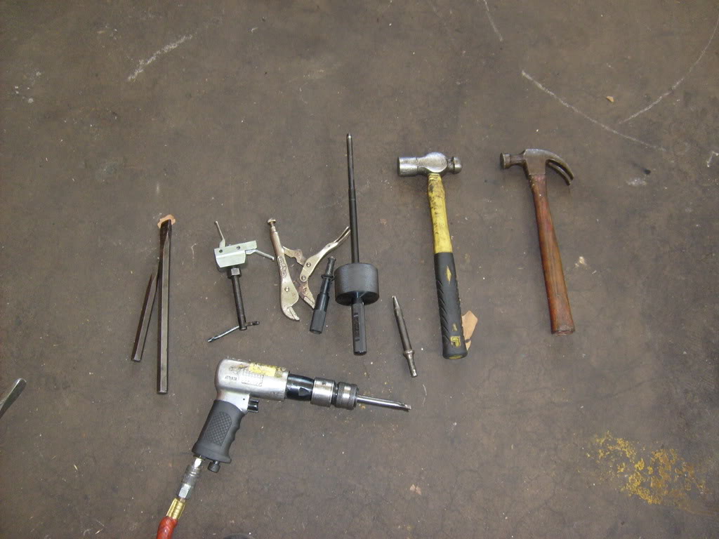

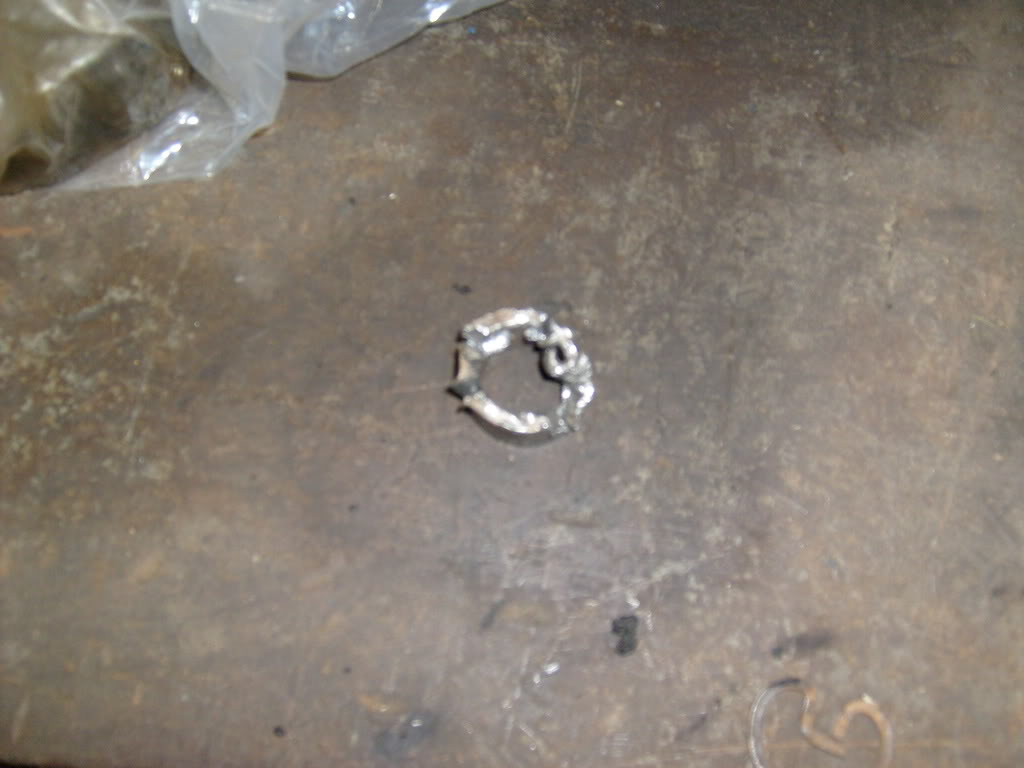

So yesterday I finished timing the engine (with the help of MS!3) and slapping on the accesories. Today I wanted to put on the clutch, flywheel, pilot bushing, and new rear main.......... but...... I ran into some issues. Pretty sure you all have heard of this infamous automatic adapter bushing when people do 5 speed swaps..... yeah.... it's pretty damn bad. Pics
This mangled piece of metal is what used to be the auto adapter bushing.
And my weapons of choice.....
Some of these were more useful than others. Basically what i did is use the hammer and chissel to slice into the bushing. From what I had read the bushing should have popped out with my finger after enough chisseling.... yeah no. So Then I tried using the silverish pilot puller tool...... not enough pressure to pull it out and nothing to really have enough leverage to get much force behind it. So then I tried using the black one.... didnt go wide enough.

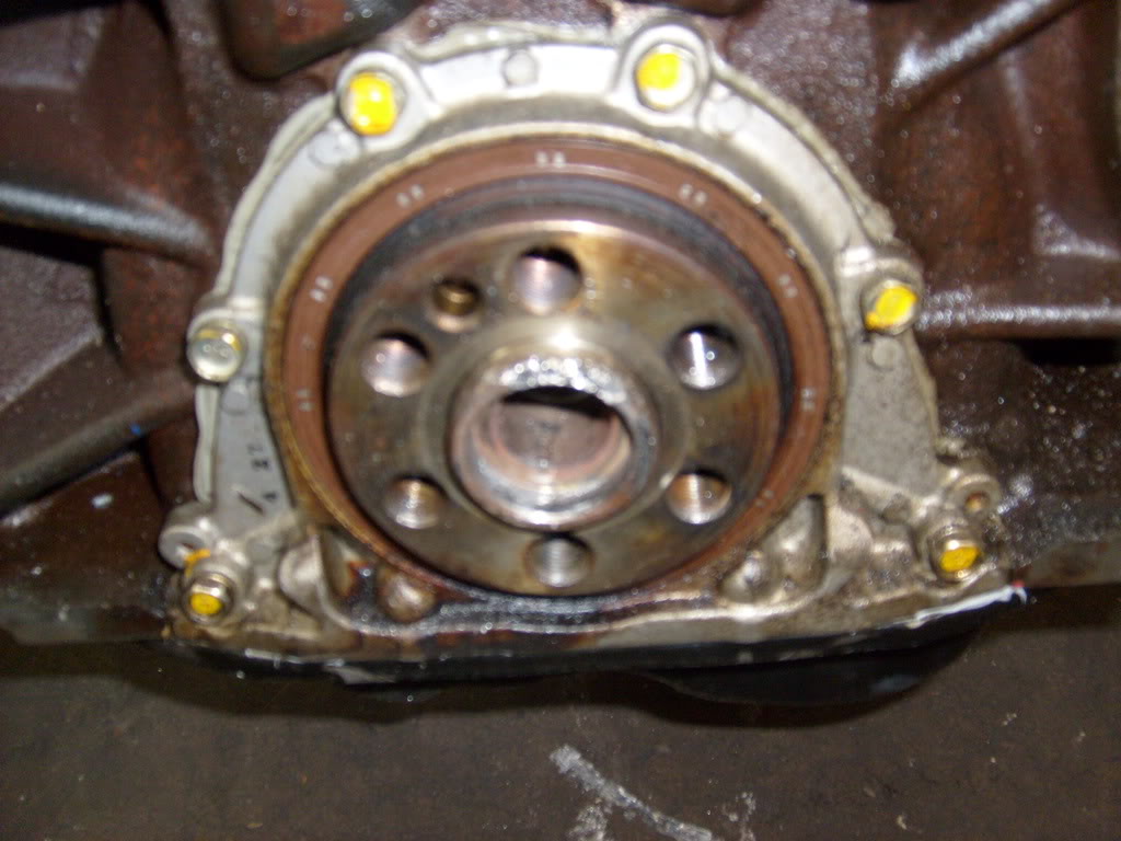

I went on to the air hammer....... yeah that thing is a beast. It started spinning on the bushing but it still wasnt loose enough to pull out. I then improvised and used the air hammer plus the hammer and chissel to bend the metal inward then used the black puller to pull on the bent part of the bushing and voila. The pilot was relieving to do after that crap. Ish took about 2 hours and about 6 slices on my hand. New rear main seal, flywheel, rps clutch, and tranny should all be on by friday and the engine should be in by saturday.... hopefully.

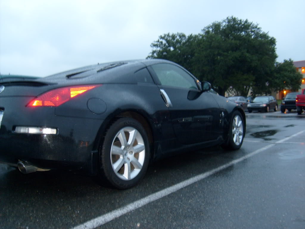

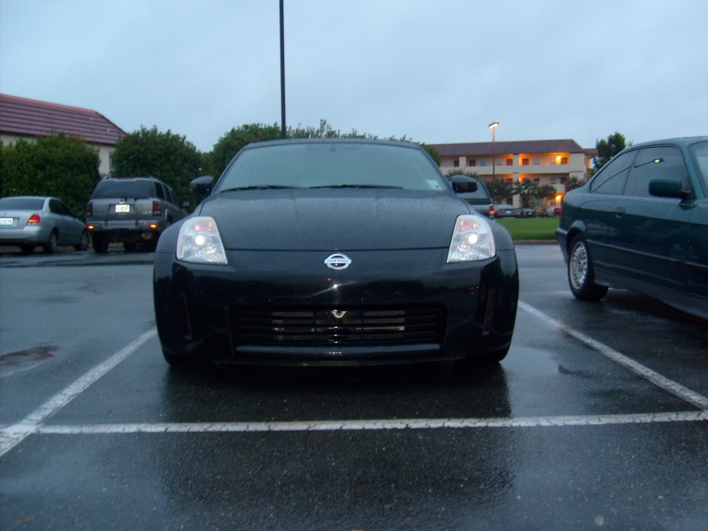

So I finally finished the car. Took forever. Alot of money too. Hope you guys like.
All the conversion stuff was super expensive.
