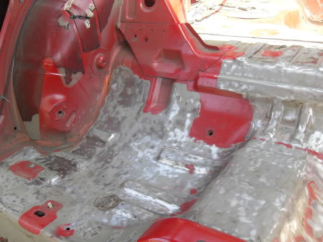

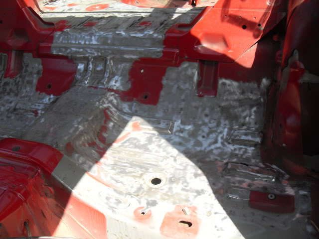

Stripped the sound deadening out of the car about a month ago.

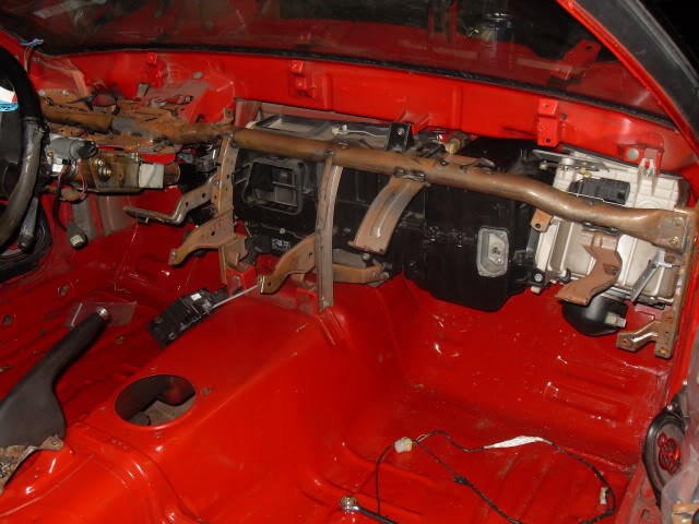

Spent a few hours in the garage tonight, put the heater core, blower, vents, petals and started rewiring the body harness.
Oh, and I also painted the interior red.
Who knew duct tape worked well for ducting? I am not using the center vent, I have 3 gauges going in there.
This is where I left off. I will get back on it tomorrow after work.

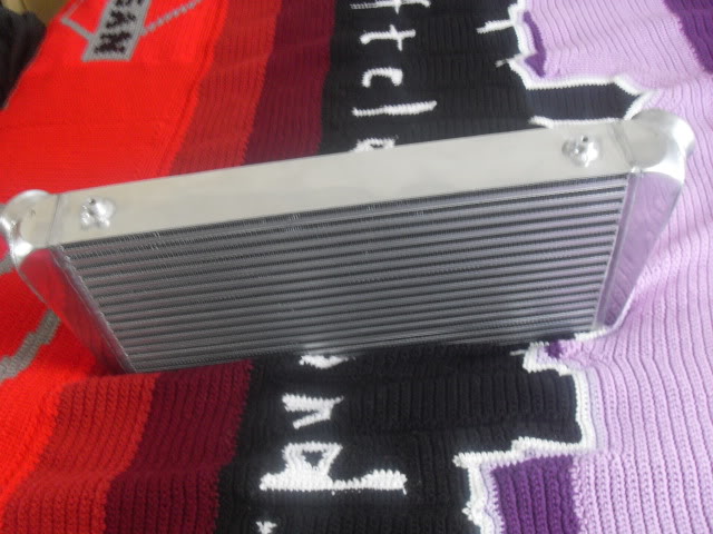

My custom intercooler. Wasnt cheap but will fit awesome for my new setup.

Couldnt wait to test fit it on my chassis. I am pretty pleased with the results.
This is the whole reason I had it modified. My damn headlight motors wouldnt clear the inlet and outlet. Now she fits perfect.
