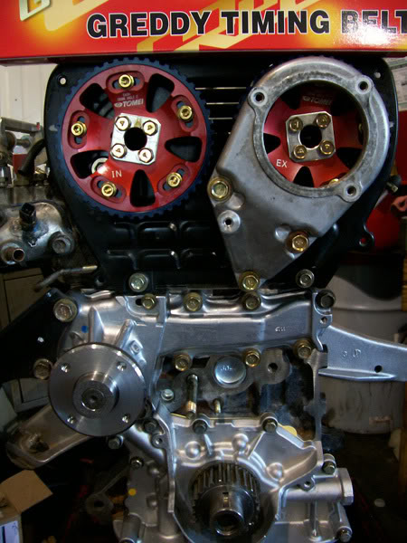

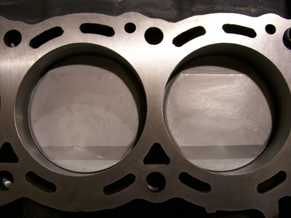

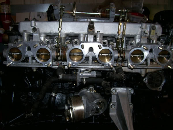

These Photos were taken 2/2007, this is part of the Stage 2 buildup.

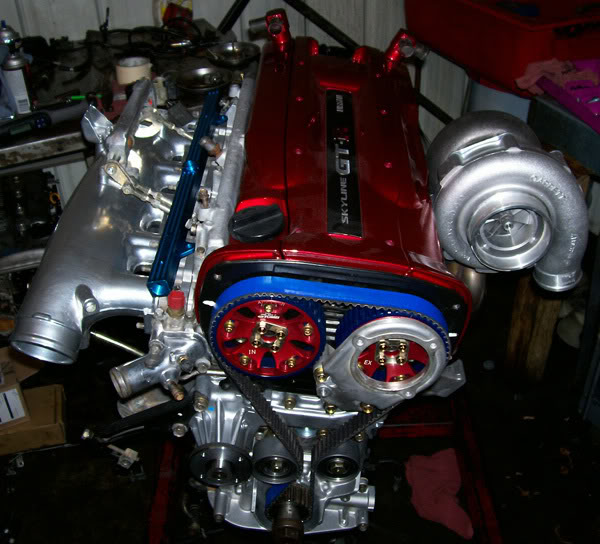

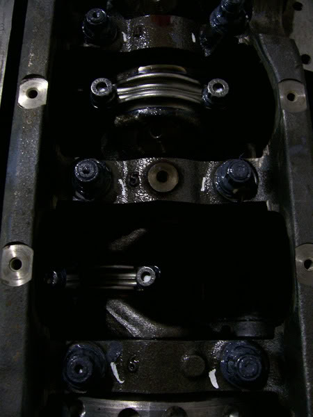

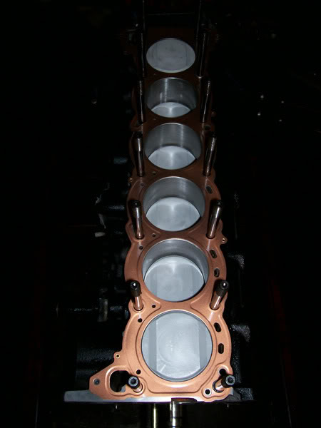

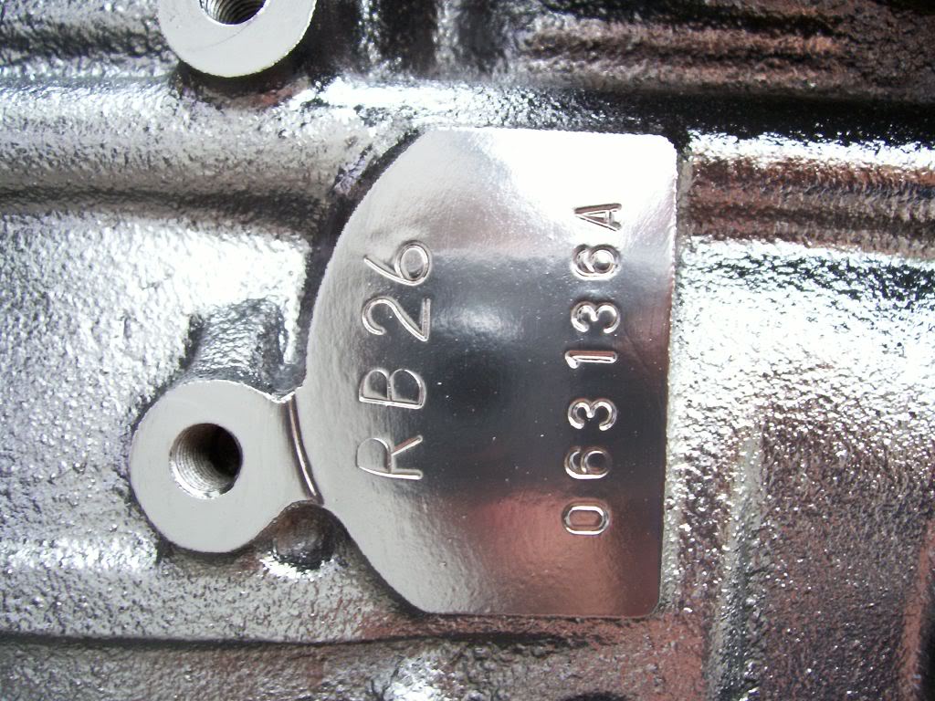

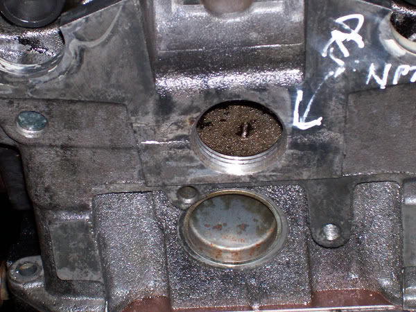

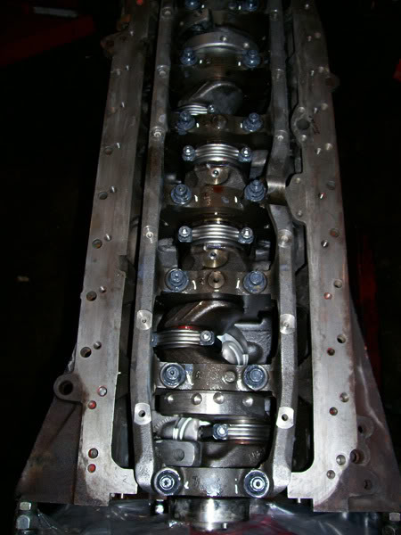

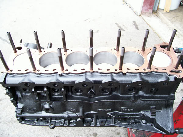

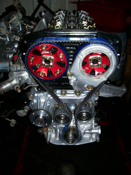

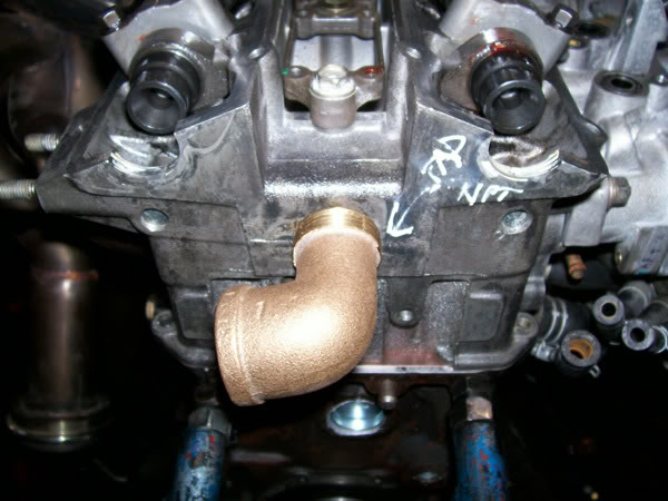

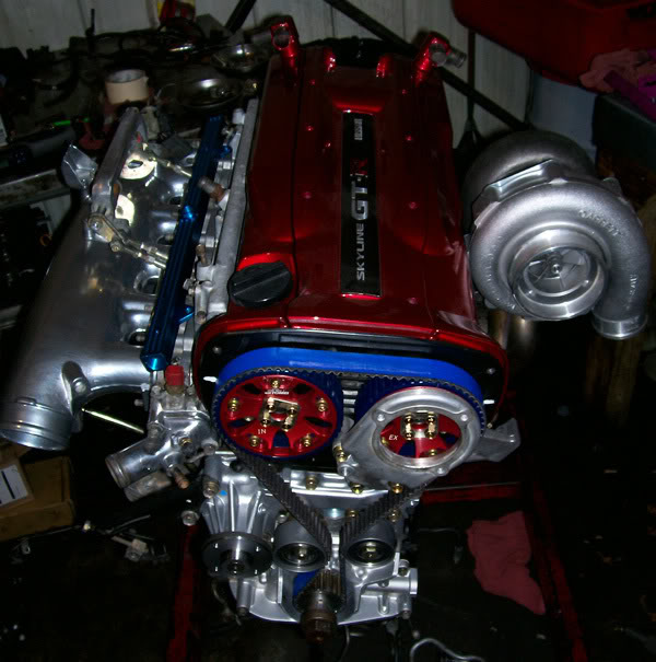

I wanted to post some pics of the build on my car to show it's progress level.
Right now, it appears like the car is 2-3 weeks from being completed.
It would be much sooner, but I am still waiting on parts to arrive from Japan.

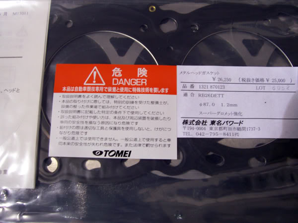

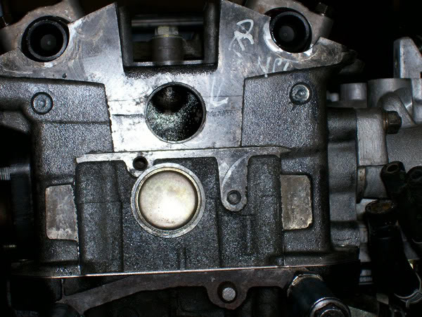

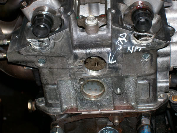

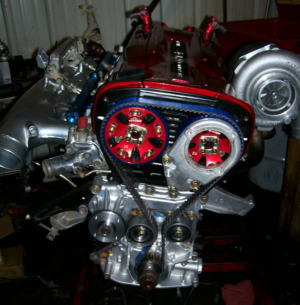

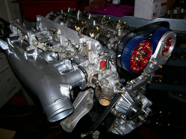

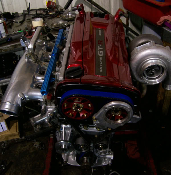

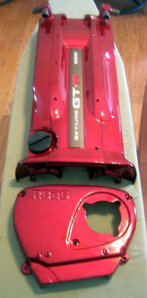

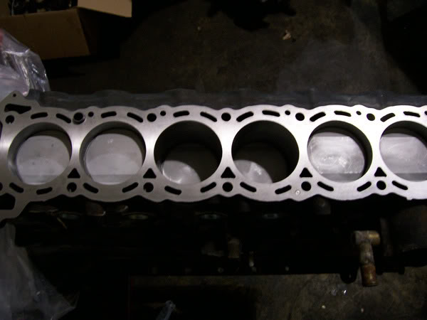

And now the latest:
