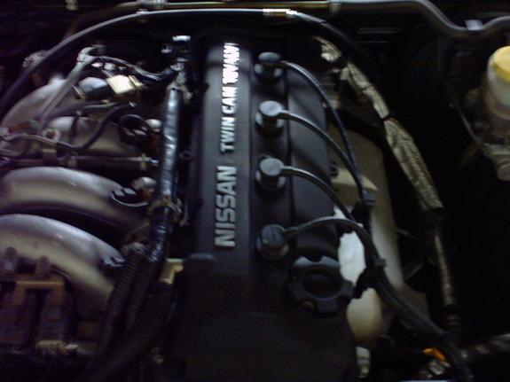

Old Aug 15, 2004 | 06:58 PM
screw getting it powdercoated, this looks just as good
