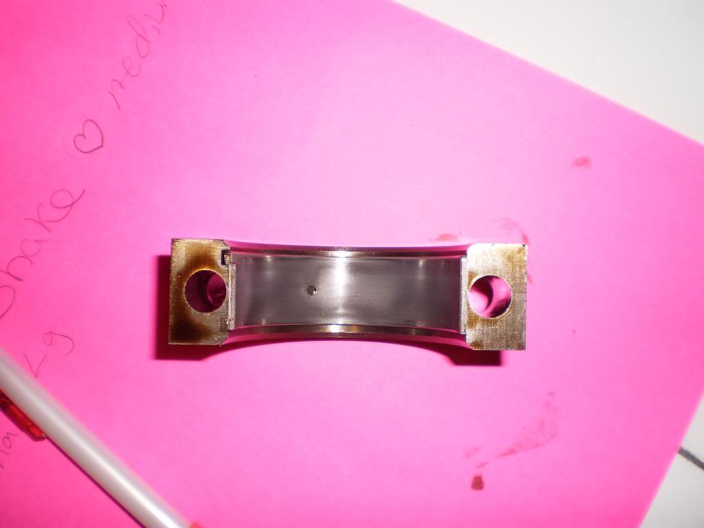

Well i checked my rod bearings last night and they looked great .

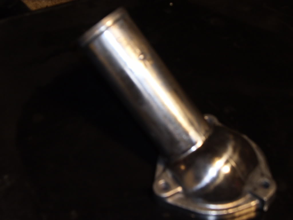

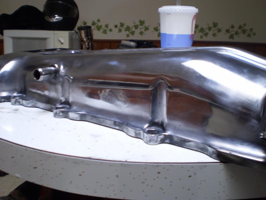

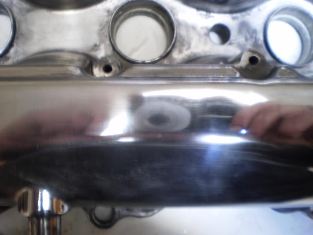

And did a little more work on my valve cover .

Im thinking ARBY's. HAHA.
Old Feb 13, 2009 | 08:26 AM
positron's Avatar
Posts: 1,192
From: Starkville, MS.
LOL yeah, Arby's FTW!

sent it back due to blown oil seals and no water lines hooked up or on the engine. Well i checked the rod bearings last night they all look brand new and i re torqued them to spec so everything is going well .I will be putting the bottom end back together starting tonight . I went out and bought some Toyota gasket maker for oil pans 18.00 something a tube but its good stuff . i also saturated the rod bearings with lucas oil stabilizer and threw some on the timing chain and down the oil pick up so i wont have a dry start up when i get it in the car .And yes arby's was dam good lol .Still got to clean the aluminum secondary pan .

HAHA. Sorry, I was staring at the shiny thing and then I saw the Arbys hat. HEHE.

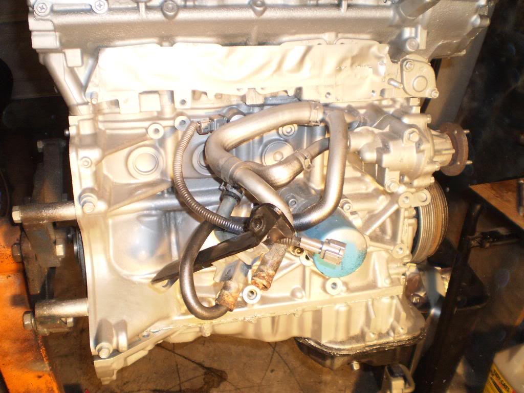

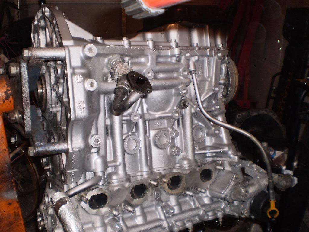

well heres some more piks and a pik of one of the rod bearings .

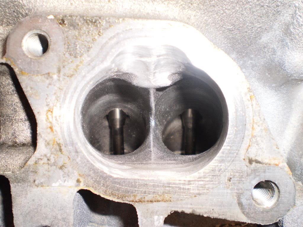

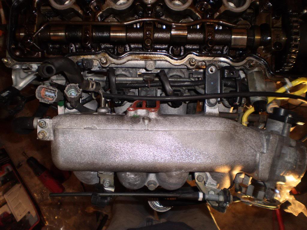

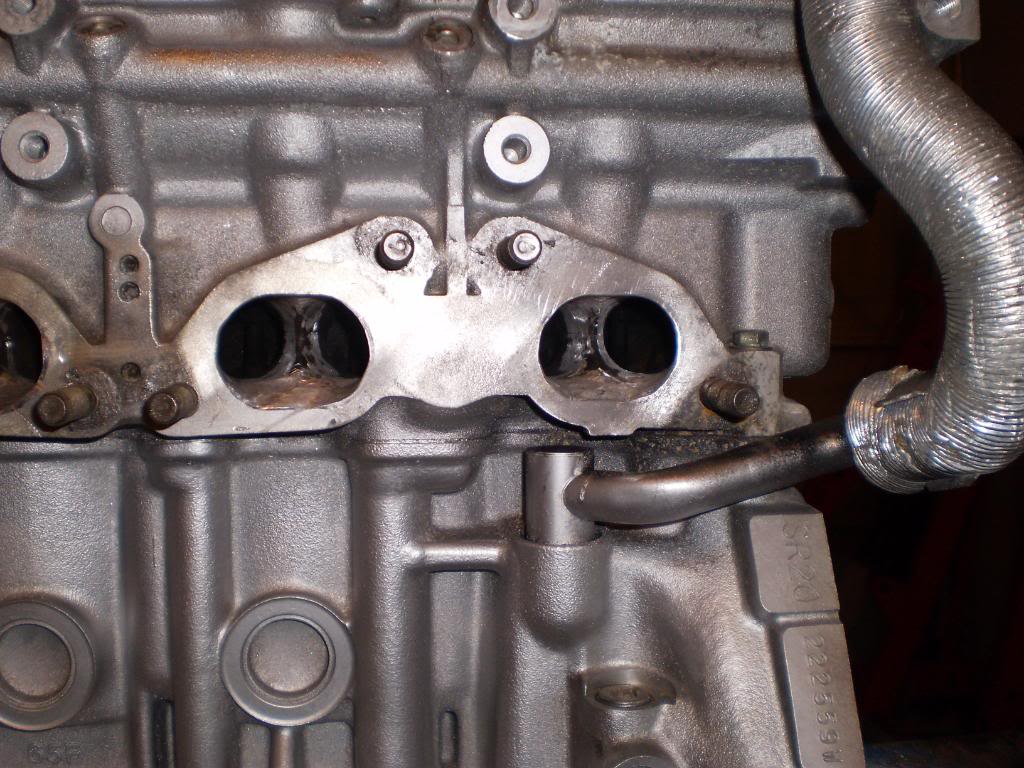

Well some more pics .Name:  013-2.jpg

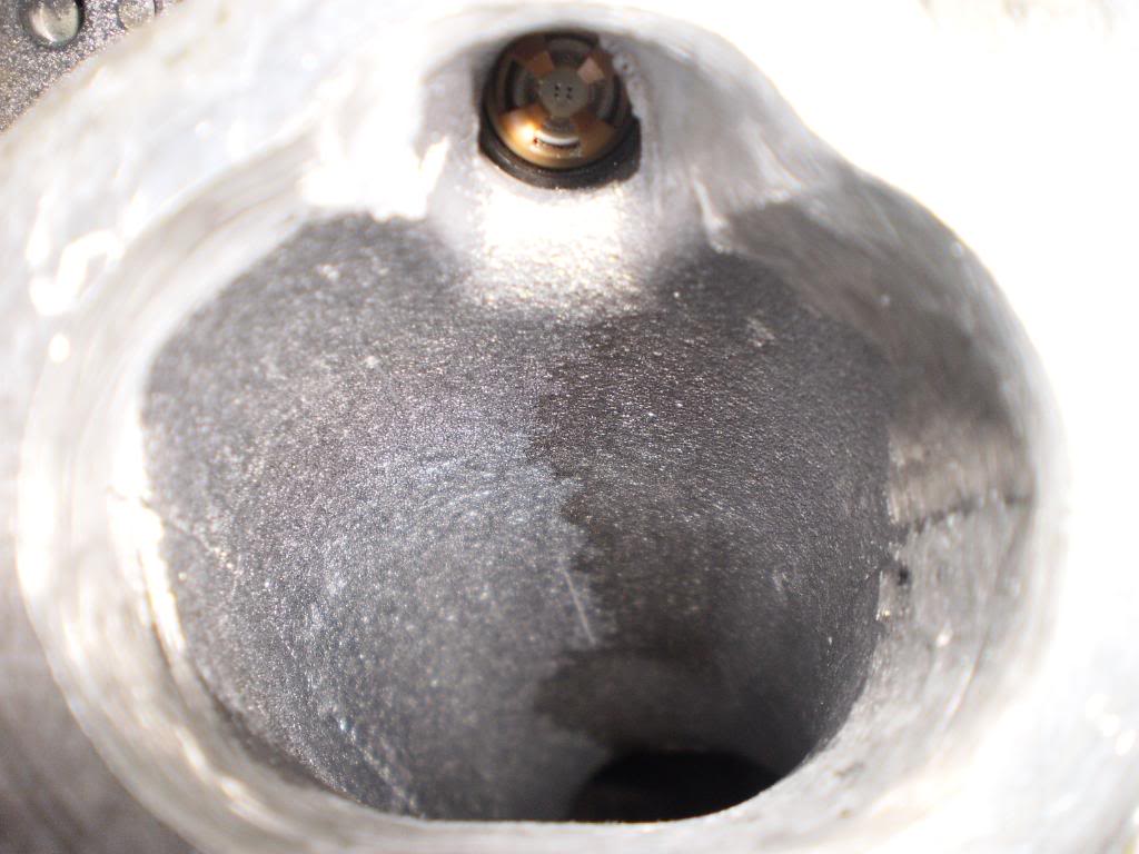

lil port on the intake side of the head .Name:  037.jpg

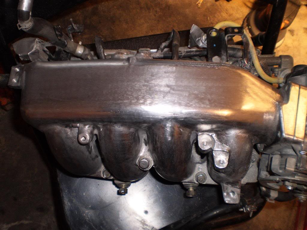

Size:  110.3 KBAnd the intake itself .Name:  022.jpg
Size:  83.5 KBAnd the intake side of the engine .Name:  041.jpg

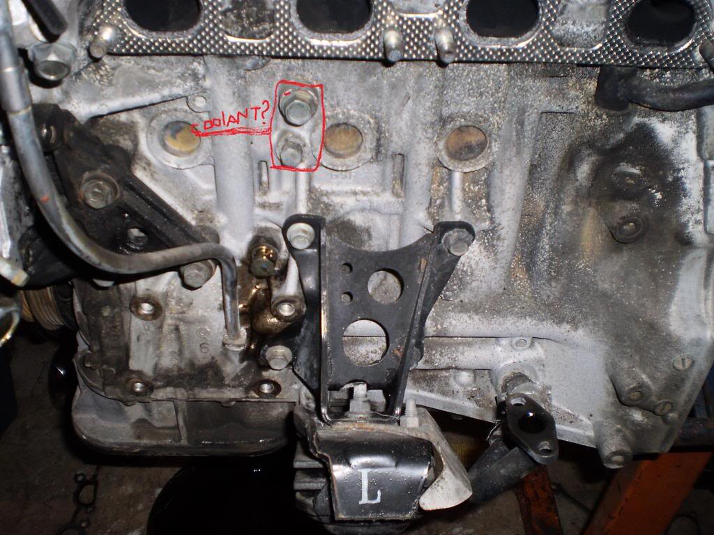

mad-ass's Avatar
Joined: Jan 2008
Posts: 382
From: Nor Cal
sweet sweet!
and yes, that's the main engine block coolant drain bolt. the bigger bolt.
same for ka/sr
