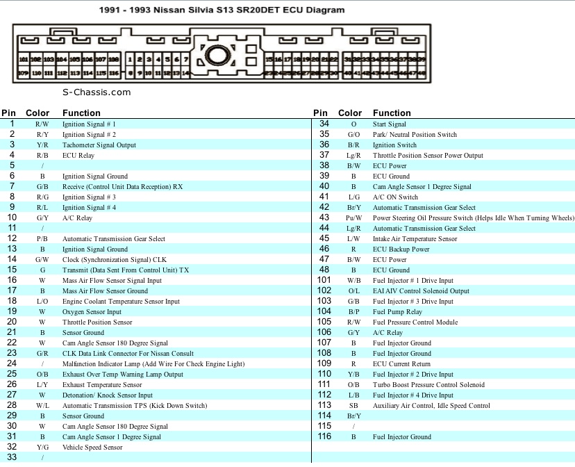

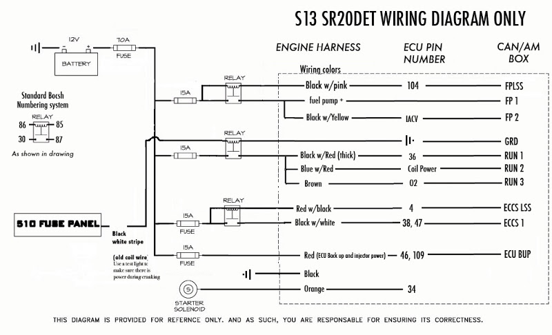

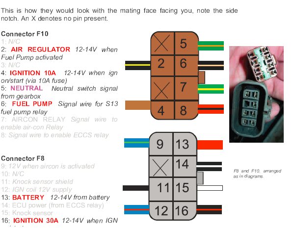

Here are some wiring guides:
yektik99
Jan 13, 2006 12:55 AM
iceperformance
Oct 8, 2002 07:23 AM
