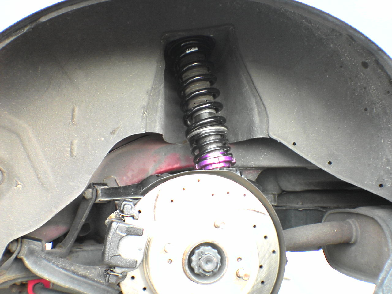

spend the extra money
if you're paying 900 for megan just save up a little more and get the Apexi exv dampers or save up more money and get some HKS hipermax d2 mine are great a little harsh on the bumpy roads because of the 12 front 10 rear spring rates but it was alot worse before i realized that it had an adjustable spring tension perch also, so now im a little more comfortable. But you ever have the feeling your bodykit hates your suspension?
Attached Thumbnails First Upgrade: Coilovers-dsc00696.jpg
