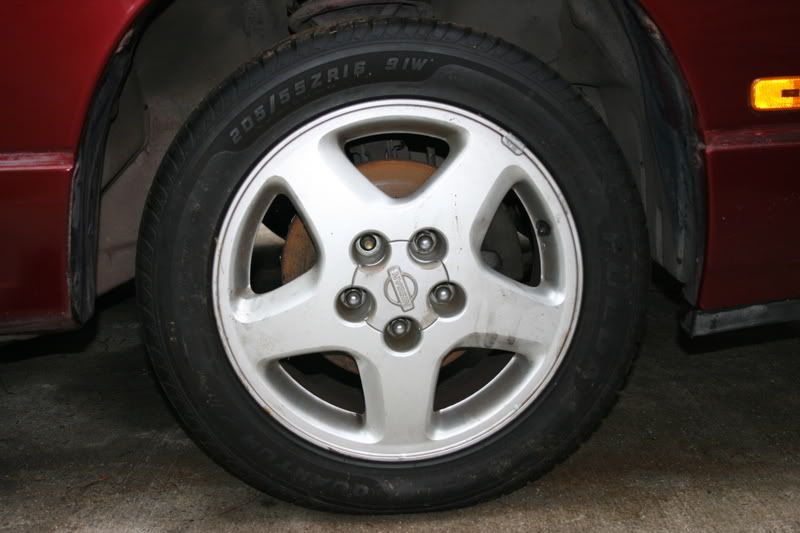

be sure to get the j30 hub nut cover as you will have to use that vs the s13's due to different cover diamater.due to the different cover design of the j30 hub vs the s13 hub you will have to grind off the taper of the wheel spindle, use of a grinder with control and patience is reccomended...do not damage the spindle threads.clean spindle with brake clean and dry to clear machined surfaces of debris from grinding which could lead to premature bearing failure.bolt up j30 brakes and line(you do not have to use j30 brakes you can use z32 front brake assembly).plum the system. and bolt up you 5-lug s14,z32,z33,or s15 wheels.and drive up and down your street(make sure to take turns as well) and if every thing works as planed (and it should if you did it right).you have less $100 5-lug front hubs!!! you still want to pay $400 for ichban front hubs?
i didnt think so!
here are some pics below on how to cut off the tapered end of the s13 spindle!
finished product
finished product
