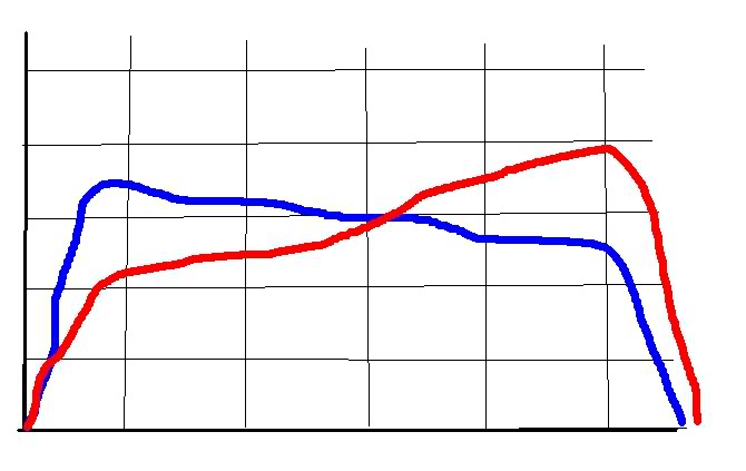

id rather have a dynosheet with a consistant powerband like this

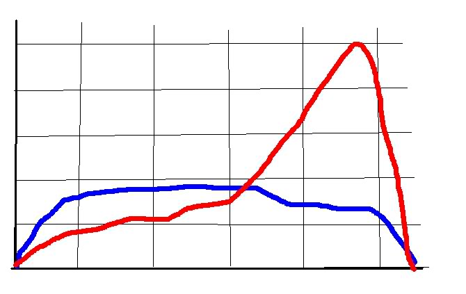

than have 480 whp at redline like this
lol sorry about the crude MS Paint drawing, i just wanted to get my point across
