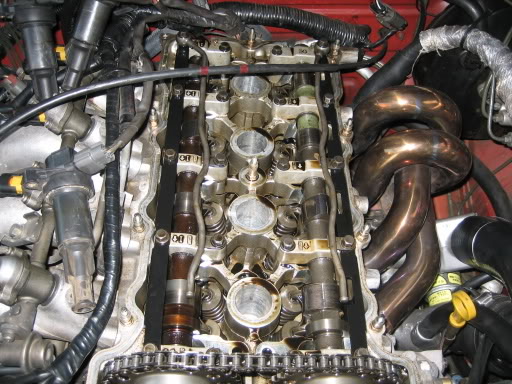

i am installing them and have no idea...pics or any help would be great.

when installing them, make sure you loosen all of the bolts that hold the cam cas down, and not only the outside ones. Once you do that then place the RAS on the outside row of bolts. The oil squirters go on top of the RAS. The RAS go in with the longer end at the front of the valve cover. After both are installed follow fsm for proper torque procedure. Make sure u get all tightened at about the same time, basically dont crank one bolt all the way down without have the other one torqued down at all. Torque is 6-8lbs (8 is what i did). If you have any questions just pm me. also make sure you clean off the head from previous seal and re-seal with high temp gasket maker in the 2 crevices in the front and back of the head. heres a pic for reference:
