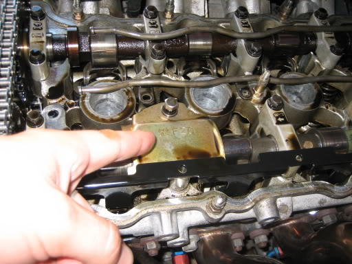

What did you guys do about this bracket?? or do i even need it?

Junk it.
Old Aug 12, 2006 | 01:15 PM
yea throw it away, just a few tips, make sure you loosen both sides of the brakets that hold the cam down or you could potentially damage the threads in the block. also torque them down 7-8lbs. in proper order.
