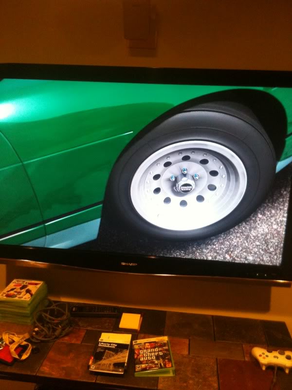

This is the look I'm trying for...
Yes I know big sidewall is not good for drifting, yes I know it's an unpopular look, and yes I know most people won't like it. The way I put my car together, this is the wheel and tire look I'm interested in.
Ok, but you still didn't answer my question about the super -19mm offset, that wheel in the pic is definitely not a -19mm offset
Old Jan 16, 2010 | 06:47 AM
Lord Umoja's Avatar
Joined: Aug 2008
Posts: 353
From: Red Lion PA
Mainly because the wheel style I want is only made for mustangs. The 5-lug pattern on the s-chassis is identical to the ford mustang bolt pattern. If I want that style of wheel I'm kind of limited to only mustang style offsets. I'm going to bite the bullet and get the setup and if I can't make it work, it will go on eBay. Some times you have to take a risk to be unique.
