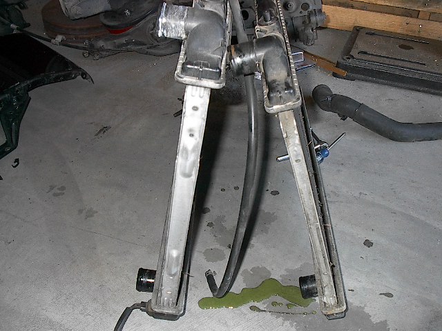

radiator comparison
Here's a pic of the KA and RB R32 radiator side by side(end view), note the thicker core, about 50% thicker. The mounting studs line up so this will be a bolt in upgrade over the stock unit.

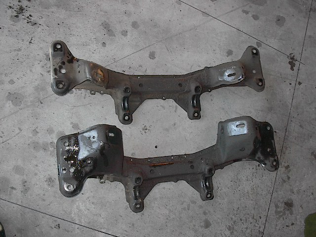

Crossmember comparison
The RB crossmember is a MUST HAVE. Either that or a set of aftermarket mounts. The RB crossmember has it's motor mounting points far forward compared to the KA, about a 5-1/2" difference. The bottom one is the RB xmember in the pic.

tell me how the engine sits with the rb xmember...i heard its too far forward in some cases....causing me to think about gettin mounts....also u had to use a impact gun to get all the extra crap off the xmembers rite??? (my friend and i were having an arguement about this...)

We'll see how it goes. If it's too far forward I'm going to have the mounting holes slotted where the mounts bolt to the block. I use air to take almost everything apart. Today the RB and crossmember are going to visit the carwash before I install them.

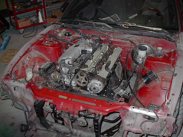

It's finally in....
Got the RB20 installed. It bolted in, no spacers, no aftermarket motor mounts, no BS. The shifter is a little forward of it's old position, maybe 1/2". There is about 7/8" between the firewall and the back of the head. The motor installed in about 15 minutes from the bottom(I had a forklift), and I spent another 2 hours bolting all my suspension back on. I found out later you can undo the inner control arm bolts, and pop the steering ball joints, and then just swing them out of the way and let everything hangs on the struts. The only problem so far is that the swaybar is rubbing on the oil pan. Mechanically this appears to be a BOLT IN SWAP! Now for the wiring

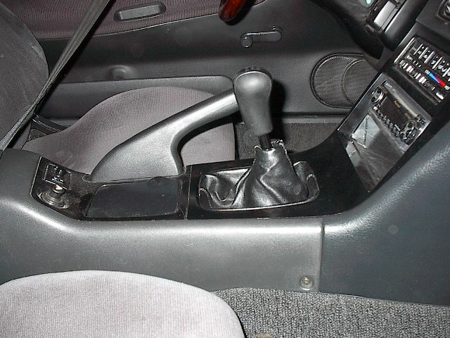

can u get me a pic of the shifter???

shifter position-Neutral
I suppose so..... it's forward a little, but theres enough room that it can shift without any interference. I might pop it out of there and heat it up, and bend it back a little when I have the time.
