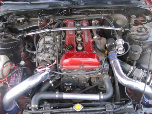

I recently purchased a 1992 Nissan 240SX SE which was previously an automatic and had a manual SR20 swap done. From what I understand, the SR motor was from an automatic car and has the auto throttle position sensor. The motor harness was hacked up and I had to redo alot of it. I was wondering if anyone might know why the car stalls when I press in the clutch?? It only does this after it is warm. Could this be the TPS? or possibly the Blow-Off Valve? I pressure checked the intake and there are no leaks. The BOV doesnt leak any air either. I am Dumb-founded by this problem. Any advise will be helpful. Thank you.

It prob doesnt help but here is the engine bay.

hmm... what's your idle set at?

I think it idles at 1100 when its cold and around 900 when its warm. The RPMs drop to zero instantly when I push in the clutch. This makes drifting rather challenging. It seems as though it floods out??? I dunno. Im confused at this point.

So I guess noone has experienced this problem then? I did some web surfing and found that the problem may be from my BOV.
