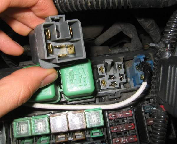

there seem to be like, 2 parts to the relay though.. the cap part that i took off has plugs that plug into the relay connected to the box..i'm so confused..

you mean the plastic lid that covers the box has things that plug into the top of the relays? If thats what you mean, they're probably there just to keep anything from getting into them. Any way you could post a pic because if thats not what you mean I'm lost lol. All the relays I've seen just kinda look like fuses.
that's what i'm talking about.. i was told by many people that that's the relay.... i think..

you've been misinformed. The relays are those red things that say "10" on the top.
EDIT: Just to inform you of the way they work. Basically they are like fuses, and if have too much current run through them, they burn up. You see where the wire that runs through them is exposed? Thats where you would test them. Look on the plastic lid to the box, and look for where the relay for what you need is located. Then pop that out, and pop out one of the other ones, and switch them. If your lights work all of a sudden, it was a relay that got messed up. I dont know how it would be a relay though, because if it was, I dont think you'd have any lights at all, but its worth a shot. If it is one of them thats the problem, just go to the auto store and buy a few of them to keep handy. AND NEVER EVER REPLACE ONE THATS RATED HIGHER! If it calls for a 10, do NOT go higher then a 10. If you do that, and they get too much current it'll burn up the wires and could start a fire and take your car straight to the ground in flames.
