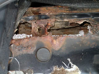

well this is what i am going to fix, not to mention the rest of the wholes that are there from the seatbelt bolts and such.
now as for the fiberglass, i would do that from the inside of the car correct? does anyone have any pictures to demonstrate
...fill the holes from the back side... if dsome of the fiberglass comes out of the hole dont worry about it as you will be sanding that down...
do you mean back side as the bottom of the car? as for that i thought you always fiberglass ontop..
either way heres the pic of what the main problem is with this.

holy ****... this is not a fiberglass repair at all... this needs to be cut out and welded with a patch panel... i was thinking of the spoiler problems that everyone has... that is serious rust... but anyway...
what you are going to do here is cut out the metal that is rusted... cut about an inch farther than the hole... then get some 18 gague sheet metal and form it to the contours of the hole... and weld it into place... i cant tell where that rust is so if you could tell me what part that is i will give you a more detailed set of instructions... or you can catch me on aim wikd24d and i will help ya there...
