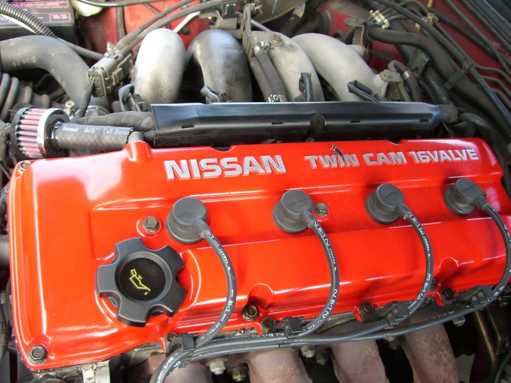

Old May 27, 2007 | 04:24 PM
FuriousZ's Avatar
Posts: 249
From: Amarill0 & Dallas, TX
here s a picture
i used left over paint that i used to paint the brake calipers of my Z.
And clear coat.

Old May 29, 2007 | 01:20 PM
clubredsilvia's Avatar
Joined: Feb 2007
Posts: 401
From: SWFLA.
^^^get some sandpaper and a sanding block and sand off the nissan-twin-cam-16-valve letters.
