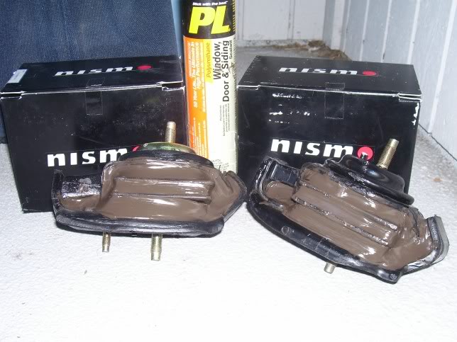

I did mine a little differently, but still the same concept. I didn't use the 3m, I used a high density polyurethane called PL window weld.

that's that same stuff i was going to use on my old mounts after i installed the cusco ones. i was really bothered by all the extra noise at first but i'm use to it now.
