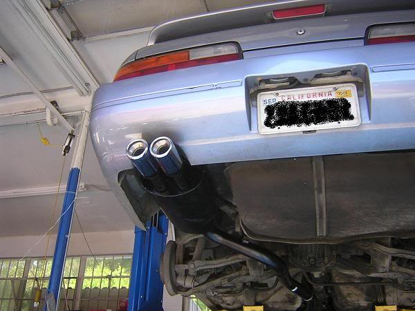

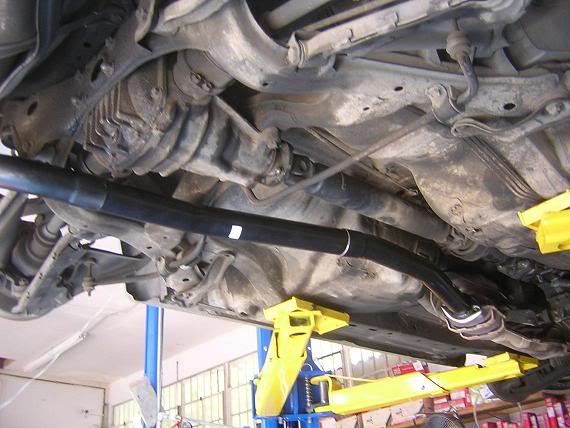

Pacesetter defenitely isn't top notch quality. How ever it does get the job done when it come's to making power. The welds to the muffler look like dog crap, but they arent even noticeable from underneath the chassis. The chrome on the tips still look good to the day I purchased it a year ago.
I have heard that some pacesetter monza exhausts don't even fit as well as mine did, and that some come in a 2 piece that aren't that well fabricated as my 3 piece. Technically it is a toss up if you get one like mine from an ebay seller. Always ask if the monza comes in a 3 piece to know that you have the right one.
Over all sound quality is good. The black paint that comes on the exhaust burns off after day 2. It is a nice tone that isn't to ricey, and it doesn't come with any resonators like most exhaust, and IMO that is the majority of the performance. Any exhaust that comes with resonators will cut down on performance.
I will leave a pic of my install for you to decide. Also make shure you get a gasket from a chevy CAT/exhaust flange for 2.5" the pacesetter gasket is literally a piece of paper.

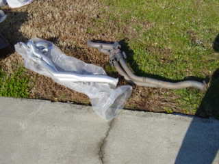

Hey Vinnie, does DC sports make headers for a 98 240sx?? Or does any company.I searched and all could come up w/ was Megan racing and Hotshot.
Because we were trying to install it yesterday and everything was going good until the EGR tube came up. Compared to your car its different.
Yours
Mine:
Do you see the difference?? I was thinking maybe (since my egr tube is bad anyways) that i could get an S13 egr tube and put it in my s14. Or if it will work or not.
Yours
Mine:
But I don't know if the angle of the actual EGR changes from the inlet port end. ( I really doubt that it does, I can't remember off the top of my head)
Hey it's worth a shot and the tube should be affordable at any wrecking yard. You can be one of the first to let us know that it works.......
If it's to much trouble send it back and get the Hot Shots..... Do not purchase the Megan.......
