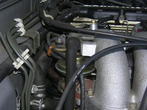

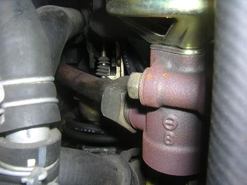

Alright first lets compare and anylize the EGR valves to see if we can use a OBD1 EGR scavaging tube......
PIC of my EGR assembly.....
PIC of yours......
PIC of mine......
PIC of yours.......
So from the PICS we can conclude that a OBD1 tube should mount up to the OBD2 EGR system. So you should be able to use the DC sports header with the OBD1 tube on your EGR system....
Now your problem is getting that fatty nut off of the EGR to get the tube loose.
The easiest way to do that is to disconnect all vacuum lines that are in the way of the EGR. Disconnect any lines that are within 12" of the EGR, you will need room for what you will be doing next.
Now remove the entire EGR from the monifold, use a ratchet to take the two bolts out that run parallel to the tube, those bolts should be very easy to take off, compared to the nut. Now when I meant disconnect all vacuum lines I meant it. Now you will need to remove the EGR from the manifold, you wont be able to do this if you didn't disconnect all vacuum lines from the EGR to BPT. Now facing the position that you took your EGR pics twist the EGR and tube together 90 degress counterclock wise away from the manifold, now the tube and EGR should slide out from right behind the motor and firewall. Now take a VISE clamp and clamp your EGR down so that you can use I believe a 44mm wrench to take off that tube nut. Now you can apply the OBD1 tube to the EGR valve and make shure that it is snug, but not tight you still want the tube to have some play so that you can reinstall to the header.
Hopefully it should be self explanitory how to reinstall, since you uninstalled.
PIC of yours......
PIC of mine......
PIC of yours.......
Parts that will need replacing:
3/8 vacuum line for the EGR BPT
New EGR gasket
Might as well clean your EGR while you are at it with some carb cleaner, get all the exhaust crap out your EGR will work better and possibly last longer.....
