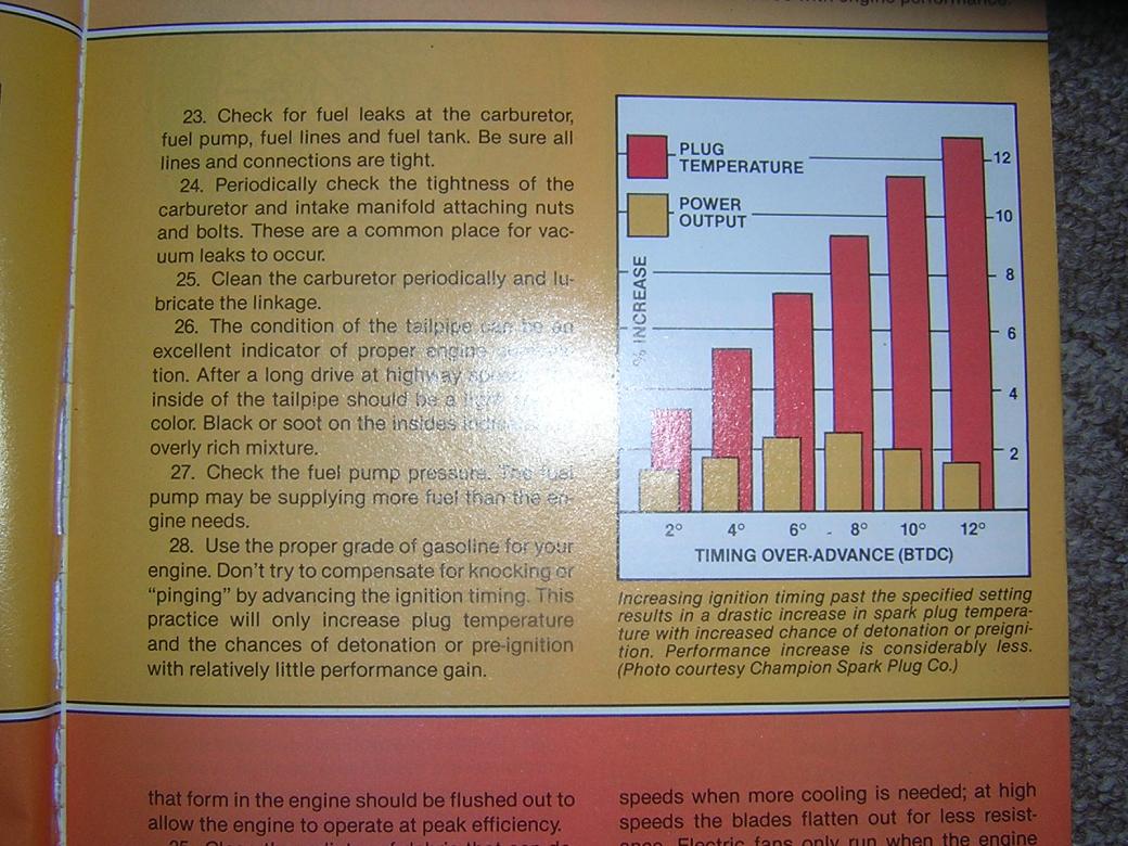

HAHAHA I feel like the MAD Scientist today, here is the info, I must remind you that the specs vary " and are speculated" from different brand spark plugs, and compression of engines. This is the rating of your basic cheap champion spark plug.....
Yes Raine you are very correct and direct with your knowledge it's a damn shame i'm not as smart as you with my english... Here is the pic.....

Diminishing returns past 6° I see.
