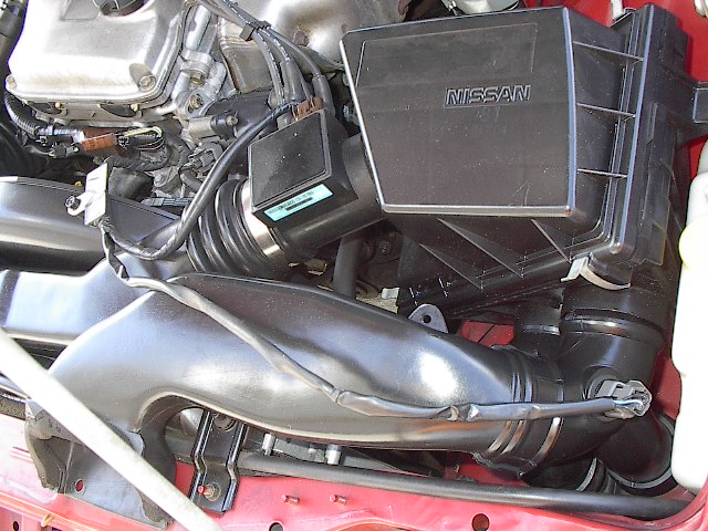

I cant figure out what the hell this sensor/wire or whatever the heck its someone plese tell me if i can take everything out and put a filter in here are some pics.

on the bottom right of pic.

Looks like IAT to me.

so what do i do with it cuz im gonna have to take it off to put a air filter.

Checked the 97-98 FSM's and it is in fact the IAT sensor.
For 95-96 models the IAT sensor was attached to the actual OEM airbox with 2 screws; even your generic aftermarket "Ebay special" intakes came with a MAFS adaptor which had provisions to mount the IAT onto it using the same factory hardware.
However the IAT for 97-98 looks to mount a different way.
You can get away with it hanging outside the intake stream, but it will affect your cars response somewhat, and it's possible that you might throw a CEL + ECU code if it reads out of its range... From what the FSM says, unplugging the thing entirely will definitely throw a CEL + ECU code.
My suggestion is to install the new intake, find a suitable spot on the air filter itself, and drill a hole for fitting the IAT. You can seal it in place with a little silicone. That should work out fine.
I was going to suggest drilling straight into the intake piping, but that would position the IAT sensor behind the MAFS - and it's supposed to be upstream, before the MAFS.
