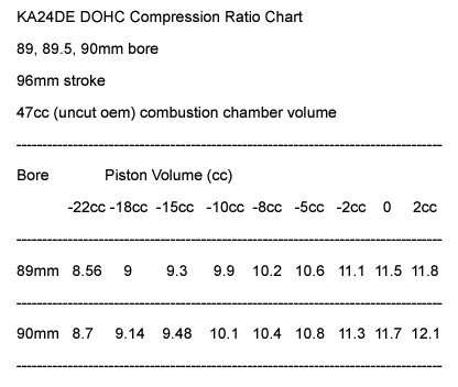

Combo recommendations are goin to be a bit slim, honestly, a lot of information I must keep hush hush in regard to full race engine building.
So you are looking for 10-10.5:1 compression ratio using 2.4l ka rotating assembly and 240sx de head?
Are you planning to invest in a custom forged piston?, If not, ka24e pistons which yeild 11.1:1 compression ratio are best bang for the buck option. This is a good compression ratio for your 240chp. If your planning to hit your hp wheel mark, you will want a very high compression ratio. Id suggest something more along the lines of custom forged 12-13:1 CR with redesigned and matched combustion chambers.
Personally I like to run a shorter light weight flat top piston with smaller volume combustion chamber on smaller displacement ka's (unlimited), but dome top pistons work well (mainly used in race form when rules prohibit modified chambers or major rotating assembly weight drop).
For 10.5:1 in KA24DE, you will need 5cc of dish volume in a piston with stock (34mm) compression distance. You can also run pure flat tops and drop them down in the deck .020" or so for same ratio, but concidering this combustion chamber has "quench" area, reducing proximity at TDC can lead to un-effectiveness and even induced detonation. Best to keep the pistons within .030" (at piston edge, if dished) from the quench area for best result.
I attached a compression ratio chart for ka24de. All verified using proper method/tools/calculations and factory components.

forgot to attach chart
