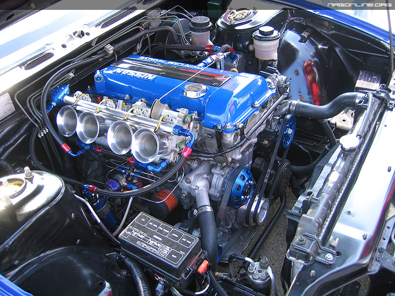

this is how a itb looks in our cars. can u say sweeeet.

yummy on that itbs pic dkdeleon
It's not much work to make it happen compared to the money involved. A/F tuning is critical though It is streetable.Yes, throttle response is def. better. Faster revs to redline, and if it would pass the smog visual, then it is all good

That looks deadly. Is it hard to tune / setup everything with one of those setups?

well, you need to run some type of piggyback ecu to control the A/F. HKS Pro V or other types will do with a dyno testing

notice the direct nos setup under the itb's

but the itbs are still pulling in hot air off of the engine compartment right?
And there is not a filter? So is this not for street and purley a track application?
Has anyone ever run them and made something like a reverse header for them with a filter and routed to pull in colder air?

on the track, you can run it open or with a filter. For the street, yes a filter is always recommend. There is another piece that you can attach to the horns to connect the filter to, an Adapter plate...
A few people have routed an air induction to them but for mostly, the itbs suck whatever air temp is there. Big gains regardless of the air temps.
