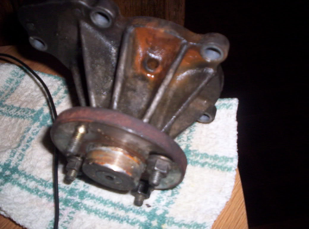

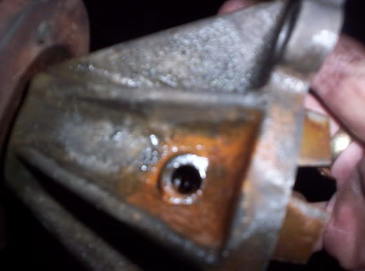

well i found the culprit, and i dunno what it is for, there are some holes in the water pump, and all my water just poured out of it. I think they are to grease the bearings or something, but water was pouring out of them.
one shot of it.
a better one.
why would water be coming out of it.....
Old Aug 1, 2006 | 03:19 PM
dkdeleon's Avatar
Posts: 593
From: arlington texas
Bad waterpump.
Old Aug 1, 2006 | 04:24 PM
barcode's Avatar
Posts: 257
yeah, that bad water pump ruin my engine lol, me temp guage didnt move untill i had the car sitting in one spot tho.....
