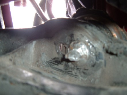

yep here's my stupid engine mount all busted up and with a nut from under the car that wont come off even with drilling, grinding, and using a dremel with those fiberglass cutting wheels.
Attached Thumbnails the stupid engine mount... pictures this time.-dscf0294.jpg

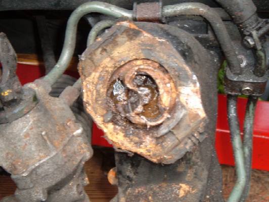

another pic
another pic
Attached Thumbnails the stupid engine mount... pictures this time.-dscf0295.jpg

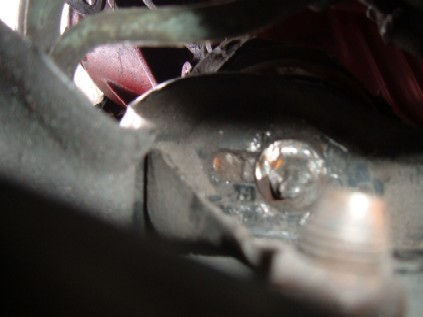

and more
and more
Attached Thumbnails the stupid engine mount... pictures this time.-dscf0293.jpg

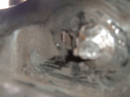

more
more and more and more.
Attached Thumbnails the stupid engine mount... pictures this time.-dscf0290.jpg

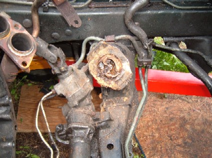

last one
last one... haha sorry
Attached Thumbnails the stupid engine mount... pictures this time.-dscf0292.jpg

that thing is shot to ****

go get a 5lbs hammer and just beat the **** out of it until it breaks off.

torch it!... that or beat the ever living **** out of it... whatever suits you

saturate the biotch in pb blaster
let sit for 24 hrs
saturate again
8hrs later, try it again w/ a stripped bolt remover.

the longer you can let it soak in penitrating fluid the better, especialy if you have like a week or two to work on it.. just spray it once or twice a day... but probably at this point it will be easyer to get a new front subframe cross memeber from the junkyard.

I finally got the damn busted mount off today... just finally got loosen enough after beating the **** out of it and i was about to just use my hand to turn it right off after it got loosen by beating it with a hammer. LOL
