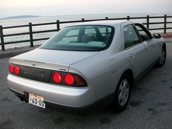

YO you Nismo Night, PSSSST Over here........... http://www.r31skylineclub.com/
Talk to the Aussies from down under in these forums all the info you need on the RB30dett and where to get the shiat you need.
Thought you guy's might want to check out this car domain also it appears that the R32 chassis and sub frame are the same as the s13 coupes. Front clips of the (R32) skyline fit the s13's, thought some people might be interested in doing a s13coupe/skyline hybrid chassis type.......
Also check out this pic....
It appears that one of the model skylines labeld' GTS (R33) has the rear tail lights that fit the s13 fast back what do ya think???????

Here's da pic!!!!!!!! Look at the compatibility between the s13 fastback and the GTS R33. Sorry labeled the pic R32 by mistake.....

I think you were referring to the S14. The R33 is distinctly similar to the S14 chassis; they were built in the same time period. The picture you posted of the R33 looks much like the rear end of a S14, nothing like the rear end of a S13 hatch.

IMO... R33 sedan tail lights too big for S14... maybe...
