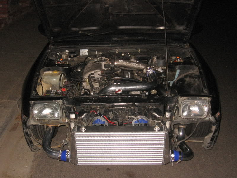

that intercooler looks like it will work fine but just for refrence on the same motor

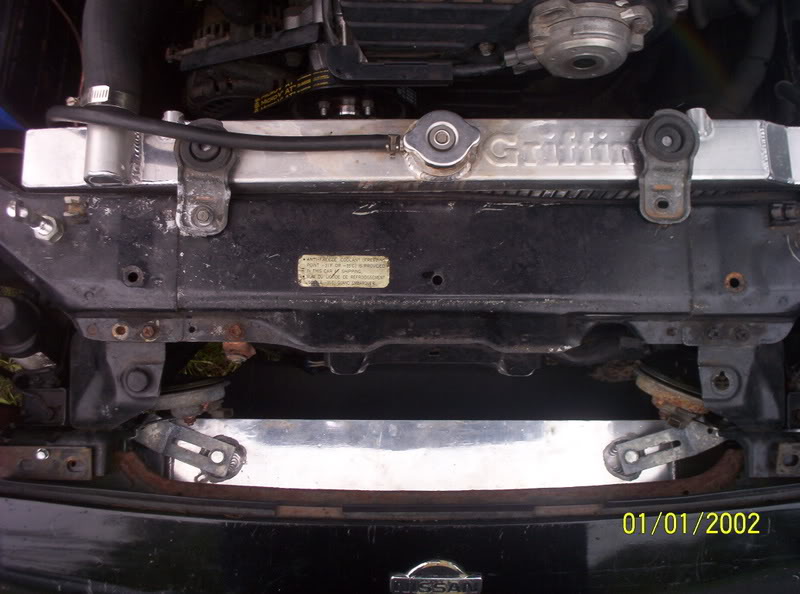

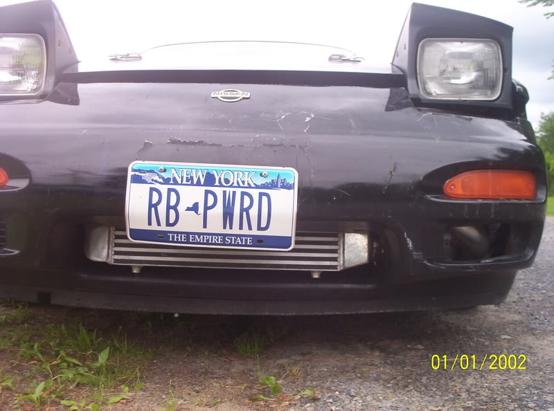

FMIC, BOV, radiator and Water pump all done. Water pump really, REALLY sucked. There was a significant amount of oil in the intercooler pipes, though. Why? Check it out.
Three things came about though (besides bumper not fitting quite right yet)
1.) Lost almost an entire psi (11 down to 10 on in-car gauge) - but that was expected
2.) Need fans on ALL the time cuz there is no more air going to the radiator
3.) BOV seems to be working double-time now. Makes noise at times it never used to, like at cruising speed and letting off.
Also, I hooked up the Tach. Man this car revs slow!! I need a flywheel and fast so I can get the clutch in too. It idles at 2100 rpms too. Which seems high to me
I'm saving up for the front upgrade (need about $450.00 to do it all properly) but lately I have been falling behind on bills so that may not happen for a while.

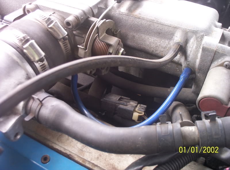

Also, in the picture below, the blue hose connects two open lines that were on the motor. the left one spews oil onto the motor. Does anyone know where these are SUPPOSED to be connected?
