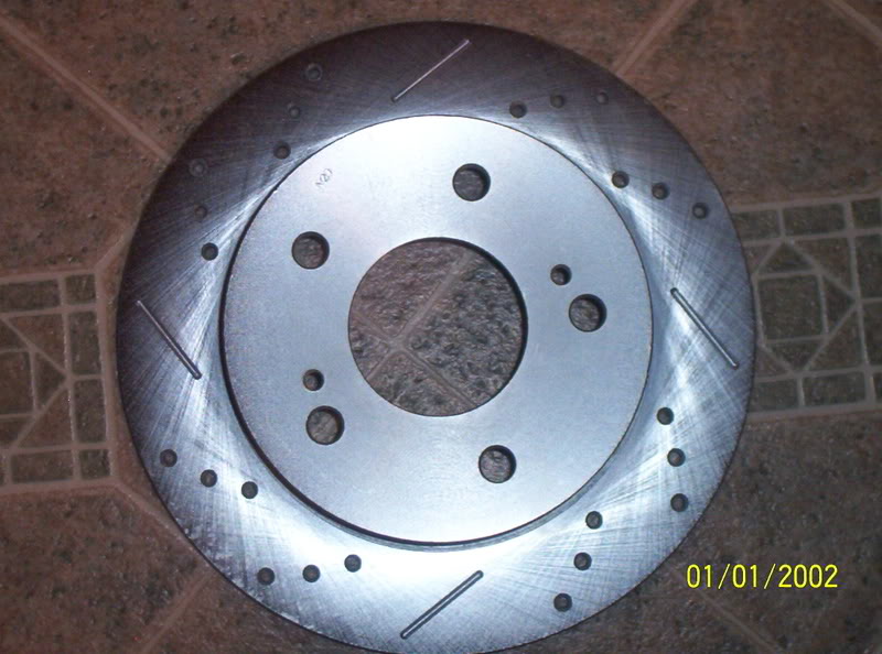

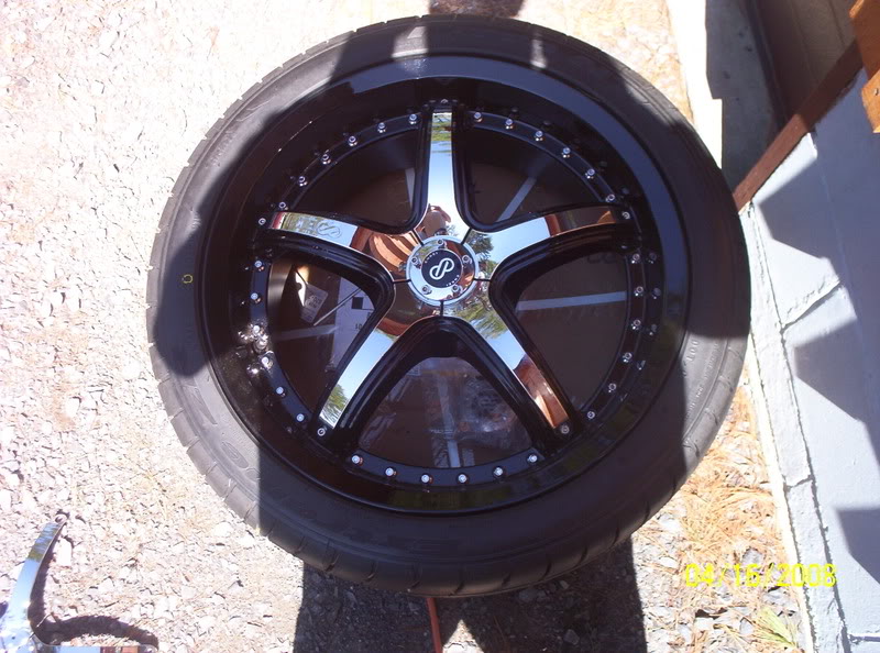

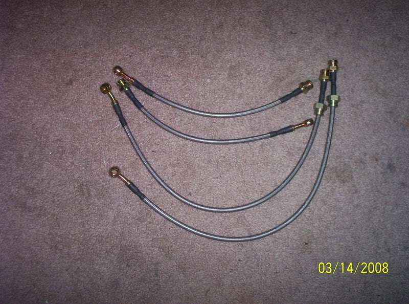

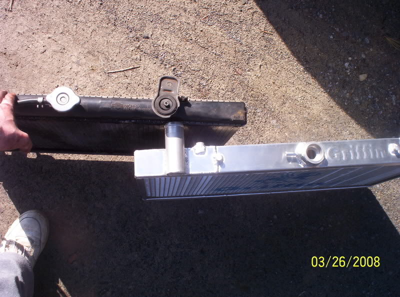

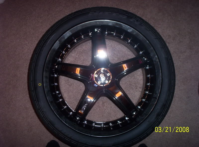

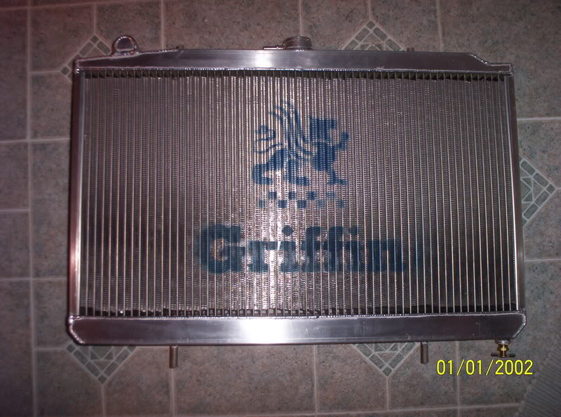

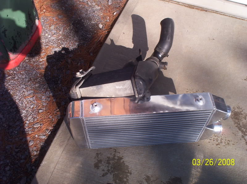

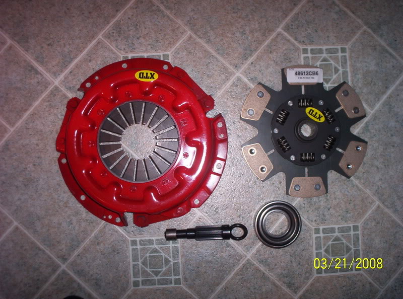

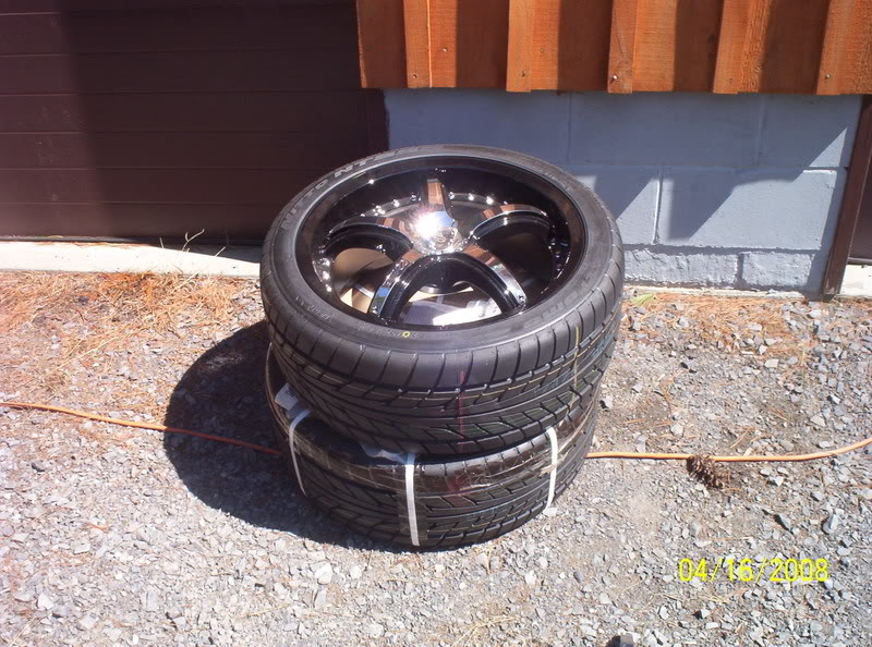

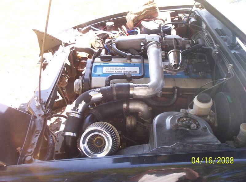

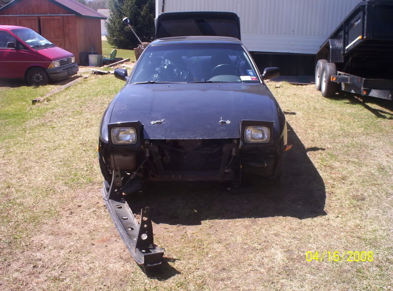

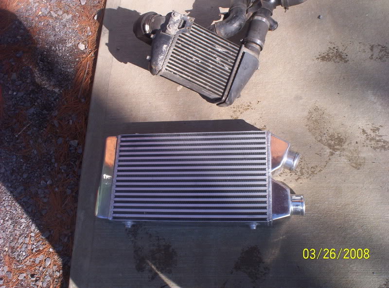

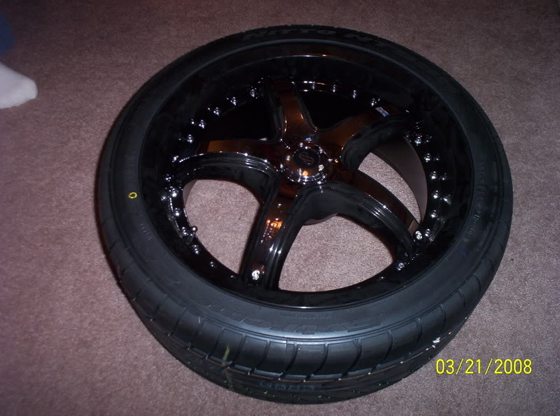

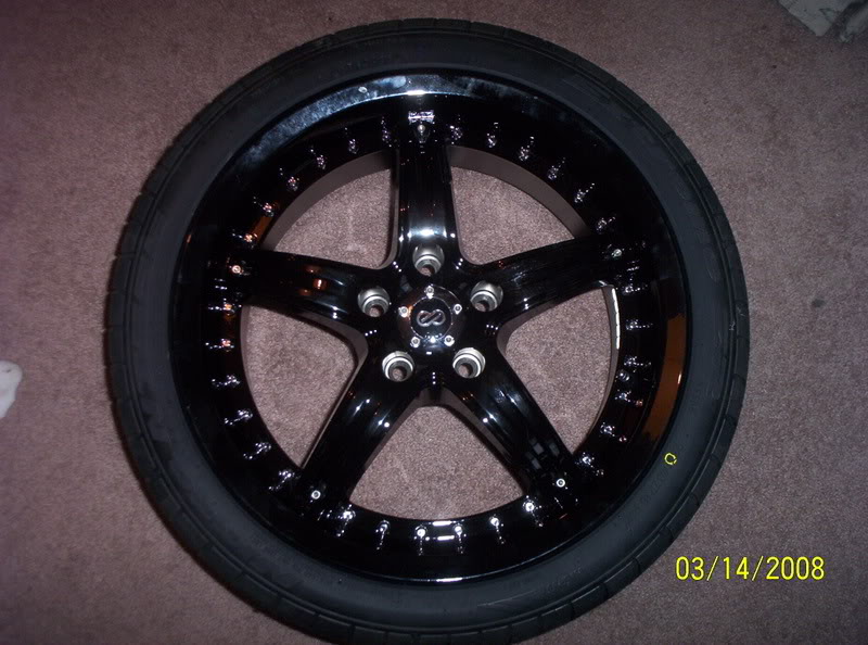

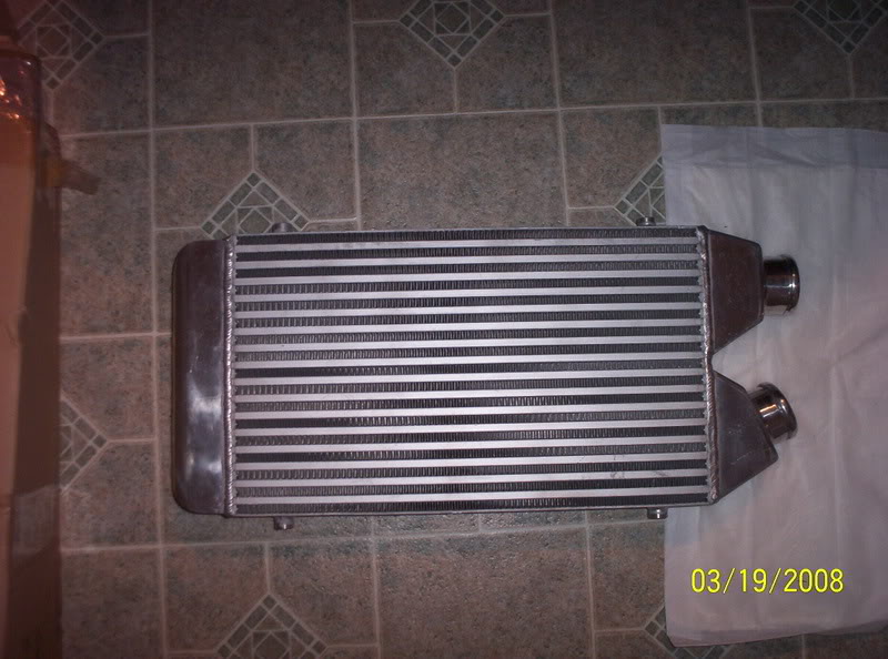

Bought all this stuff:
-Enkei LS-5 18" wheels w/ 235/40ZR18 Nitto NT555 Extreme tires

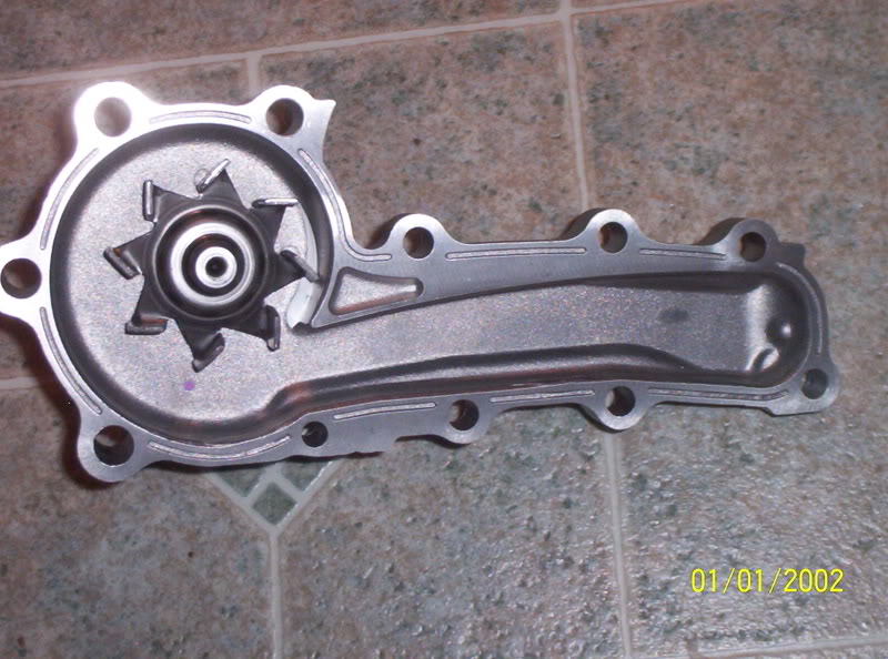

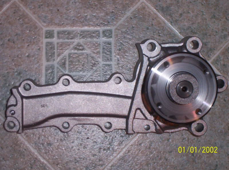

-OEM Aluminum Water Pump
-Griffin Aluminum Radiator
-Magnum SS Brake Lines
-Rotorworks Drilled/slotted rotors w/ NAPA Ceramic pads (don't laugh, they're really fantastic, especially for the price)

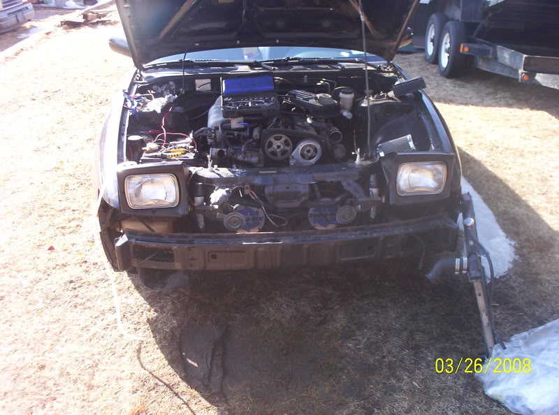

-RB-swapped specific S13 FMIC kit (missing the clamps - waiting on them but there is a shot of it installed)
-XTD (I know lol not the best but I got a good deal) 6-puck stage 3 clutch kit
-Used HKS SSQV off an RB25
-Water pump was an effing biotch because I had to remove BOTH timing tensioner pulleys to remove the bolts (I could loosen then but there wasn't enough room to get them out completely).
-Had to remove the bumper support in order for the FMIC to fit.
-Wheels only fit the back of the car for now. They increas traction TREMENDOUDLY though.
-Not left with much room AT ALL to lower the car because of the width of the tires.
-Still wants to overheat for some reason. I have bled every existing bubble AND I keep the fans running constantly. WTF else could be causing the problem?
-Anyone have an Autometer ProComp Ultralite Water Temp gauge they would be willing to part with?
-Running WAY TOO rich. Was told by several people to get a Fuel Defense Cut Off. What is that and shere do I get one/how do I do it?

Good progress.... with a stock motor injectors etc........ you should not be running rich... if so check you CAS/Timing bro.
also you never want to cut fuel... dangerous dude.. especially if you are going to be getting on the motor. ignition cut on the other hand is different but would not solve anything with you running rich. Grab a multimeter and check your injectors and make each one is pulsing and not stuck open.
best bet for low lever is to just add a simple yet effective safc controller if you under 550cc injectors have it dyno tuned and or add a wideband setup and smooth it out yourself..
looking good man.. i hope you fixed that wire issue.. that will bring you down to ground zero Very fast... im funny about wiring lol..
