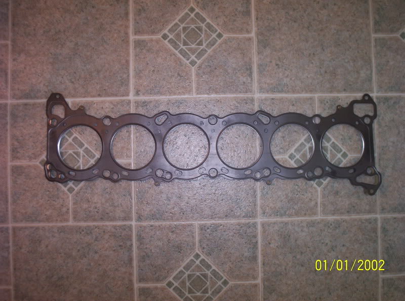

Update: Got the 1.2mm Cometic in today. Standard 80mm bore. However, there is NO WHERE WHATSOEVER for the 3 bolts I stripped to go. Maybe they aren't bolts. But either way, I got the 14 bolts out that actually go THROUGH the gasket. Any suggestions as to why the Head won't pop off? I pried like a **** and it wouldn't BUDGE.
Old Jul 29, 2008 | 07:29 AM
  #51
ErnGotti's Avatar
Joined: Nov 2007
Posts: 48
From: Amsterdam, NY

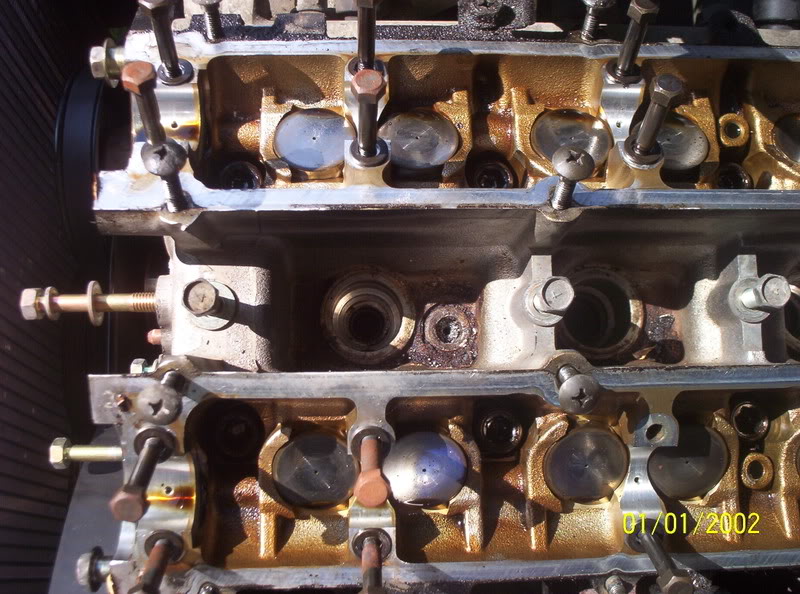

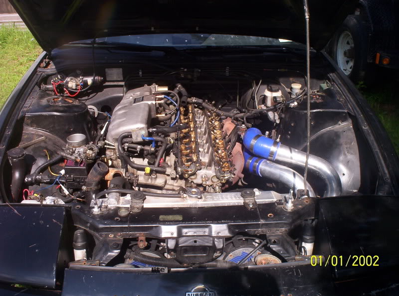

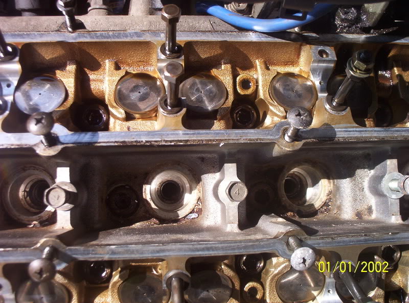

Here it is, my dilemma. What do those 3 bolts in the middle do? They obviously don't go into the block.
Old Jul 30, 2008 | 07:10 PM
  #52
ErnGotti's Avatar
Joined: Nov 2007
Posts: 48
From: Amsterdam, NY
http://forums.********.com/zerothread/325325
Found this little helper. The 3 bolts I stripped have nothing to do with the head. The 3-10mm ones are the ones I missed.

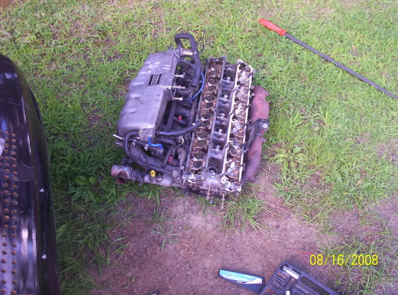

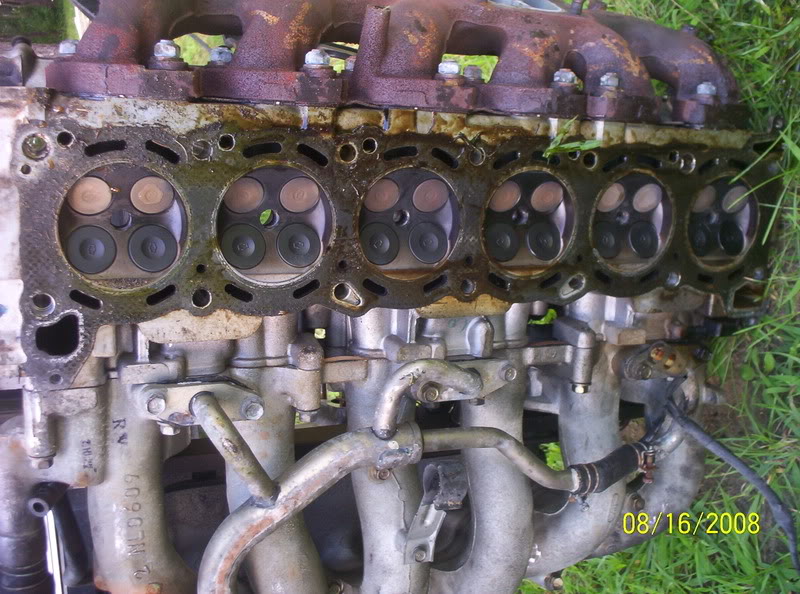

Old Aug 16, 2008 | 04:21 PM
  #53
ErnGotti's Avatar
Joined: Nov 2007
Posts: 48
From: Amsterdam, NY

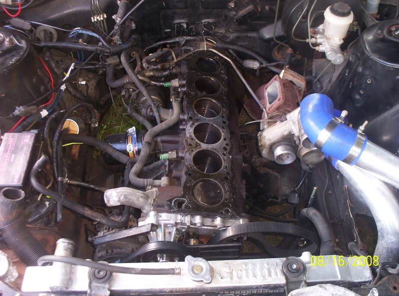

CCCCHHHHYYYYEEEEEAAAAAHHHHHHHH!!!!!

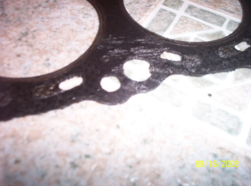

You can kinda see where the old one Failed
Now I gotta get the manifolds off and the head planed.
