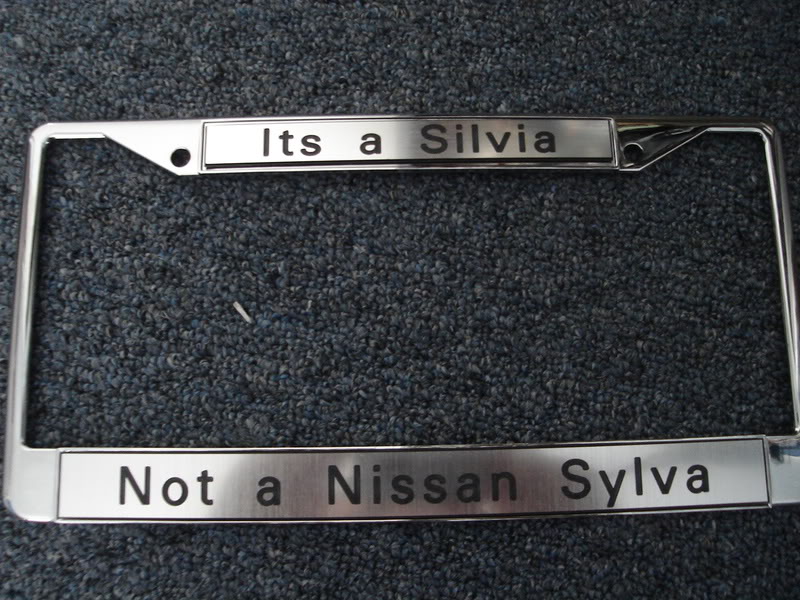

thats funny how you had a plate made.. i just did the same thing
I live in franklin nc, and the town next to us is Sylva nc.. so everyone around here reads my silvia grill and calls it a nissan sylva.. really annoying
It's prob not funny to anyone that doesn't live in franklin, but i like it lol
