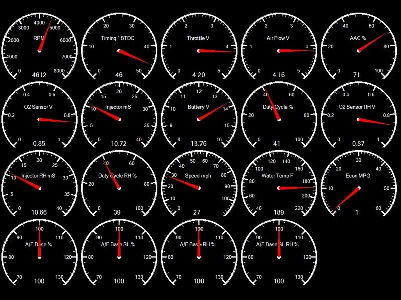

looks like i'm still not done, honestly i never planned to get this involved with this car, but here's my next step. a stanza ecu with consult capabilities, consult port, and an ecutalk cable with some diagnostic software.
i already wired the consult port to the main harness and tested it out with the stanza ecu. the hardest part of it all was finding the driver for the cheap usb to serial adapter so i could hook it up to my netbook. for those of you who don't know about ecutalk, here's screen shot i borrowed.
