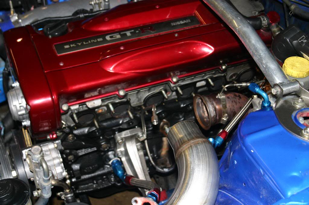

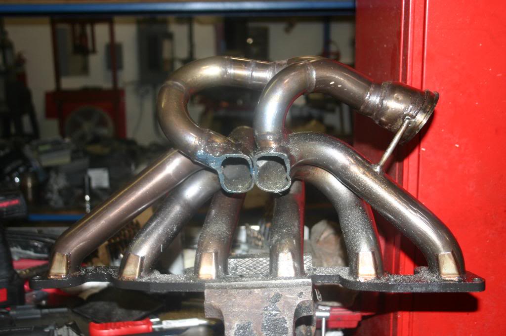

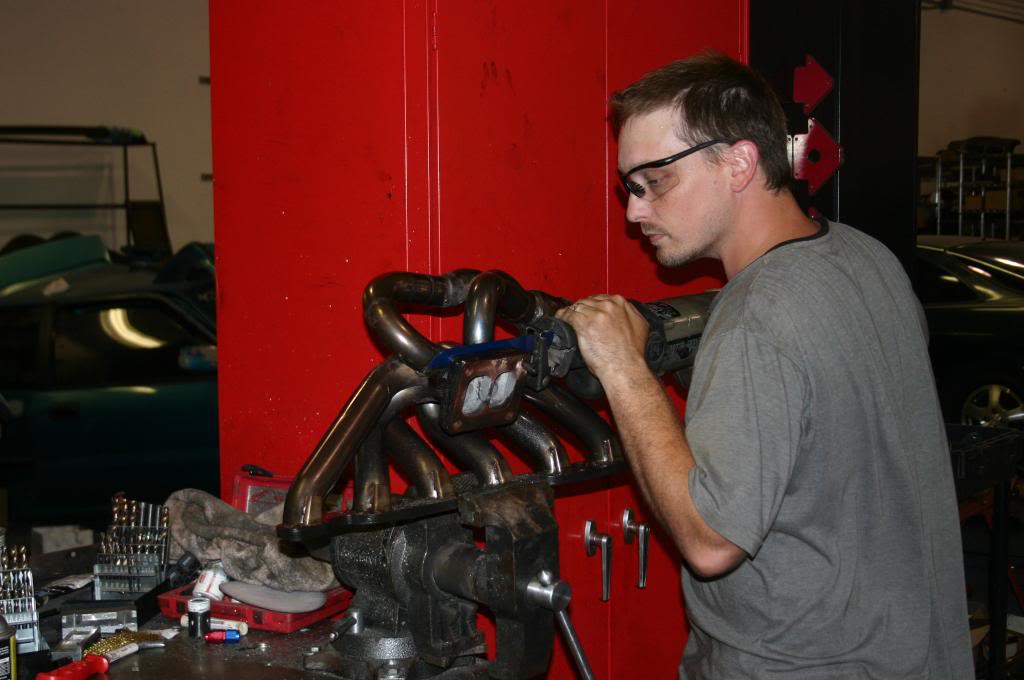

I was hoping this was going to be a bolt-on affair, with just new 4" piping needing to be fabricated......right....
The new turbo hit the valve covers, so Jason @Matchless Performance came to the rescue to modify the exhaust manifold.
The block looks so lonely without it's friend.
Starting the modification work on the manifold, basically changing the angle on the flange so the turbo sits flush.

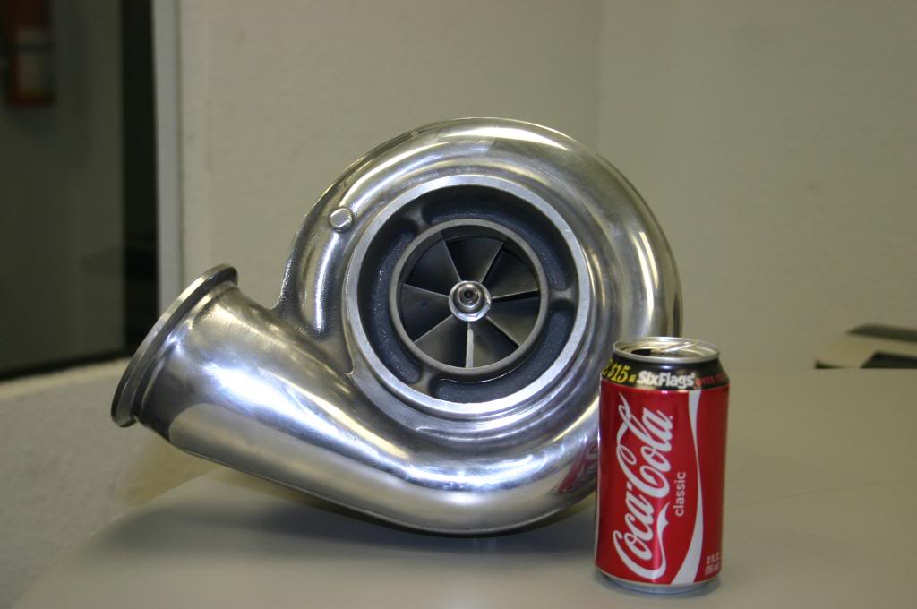

So now....the actions shots...

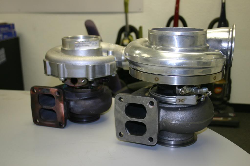

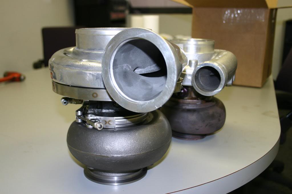

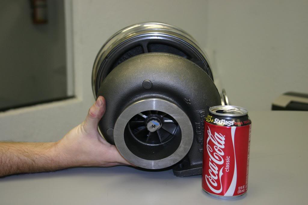

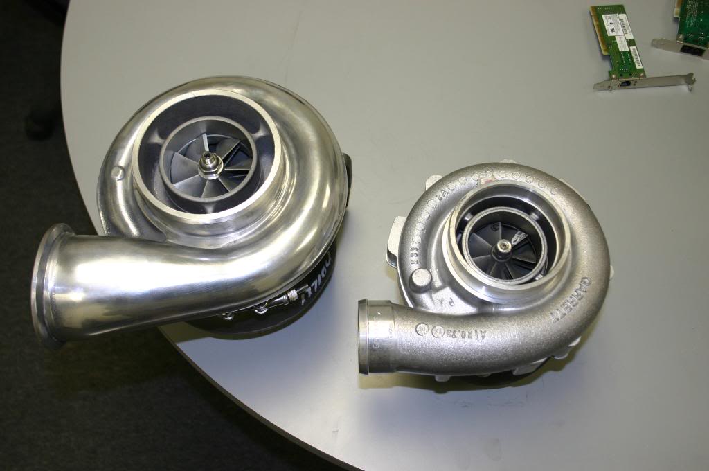

Borg Warner 74mm vs my old 63.5mm GT4088R

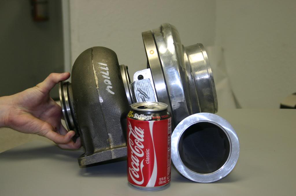

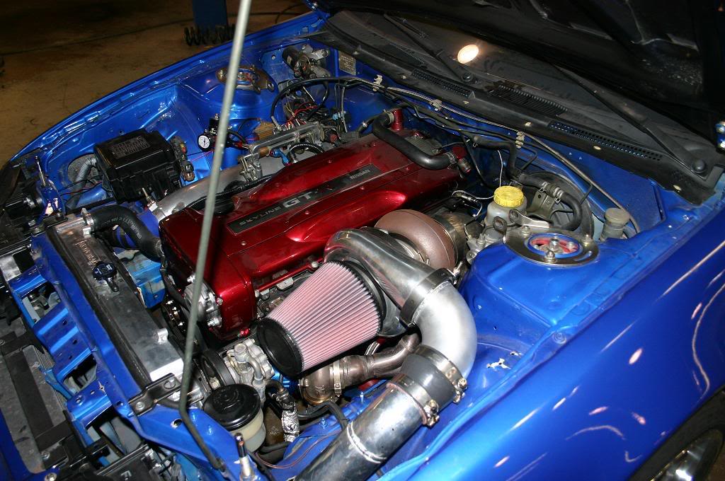

Man, Jason knows how to work by the clock. Took right at 3 hours from start to finish, very impressive.
Look at the clearance....Almost makes me want to go bigger, hum....

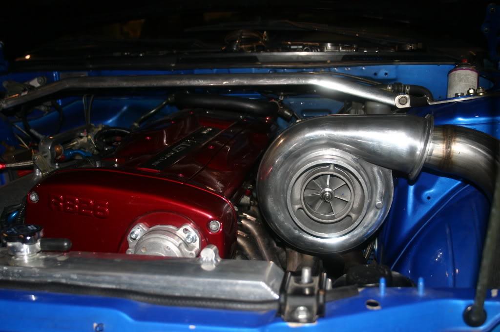

Sorry for the dusty valve cover shots, I'll get some better ones this week.

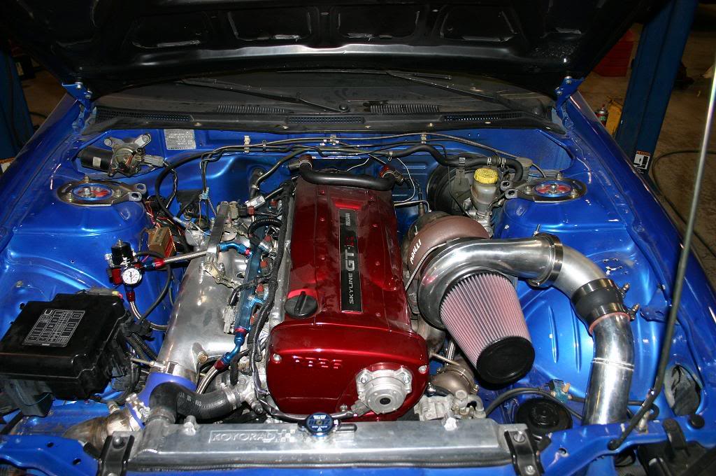

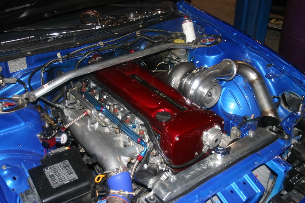

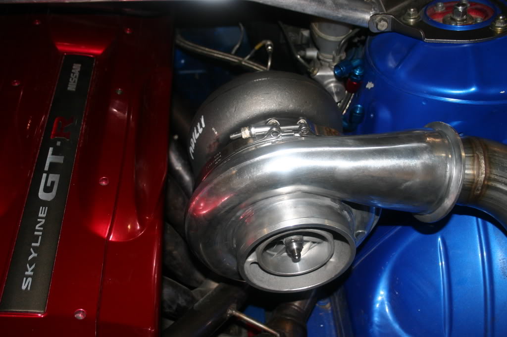

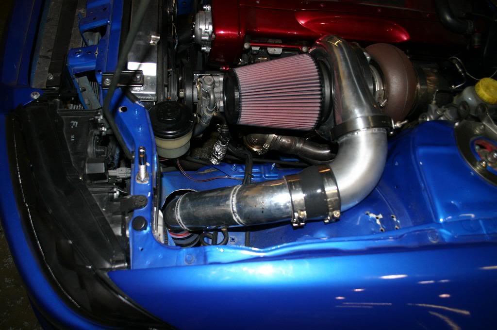

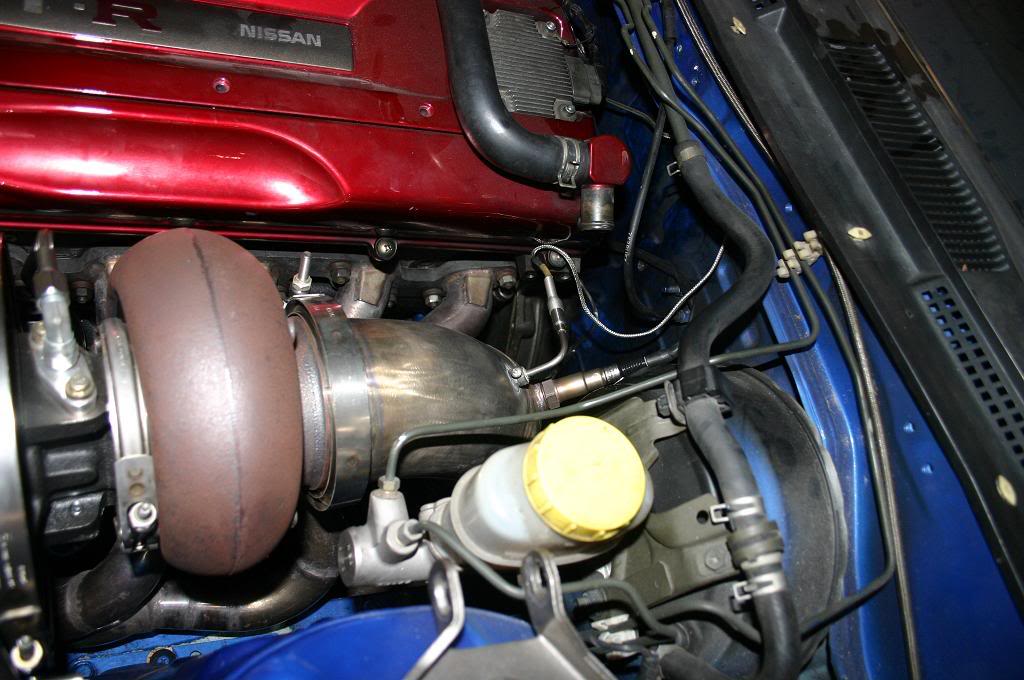

Here is the completed engine photos showing the new Borg Warner 74mm ETT Turbo.
We put the car on the dyno this weekend, special thanks again to Chris Hamilton for the tuning. You truly are amazing.
Dyno Video Link:
http://video.google.com/videoplay?do...90394196&hl=en
At 18 PSI (593whp), the car ran out of fuel, and we found the problem to be a dead Walbro Fuel Pump. We'll be going back this weekend to retune for 25 PSI, expecting around 750whp.

the car sounds bad *** man i love it but i got 1 question i see the turbo is really close to the brake master cylinder are u gona make a heat shield?
i wouldnt want the brakes to fail on this baby at the track
