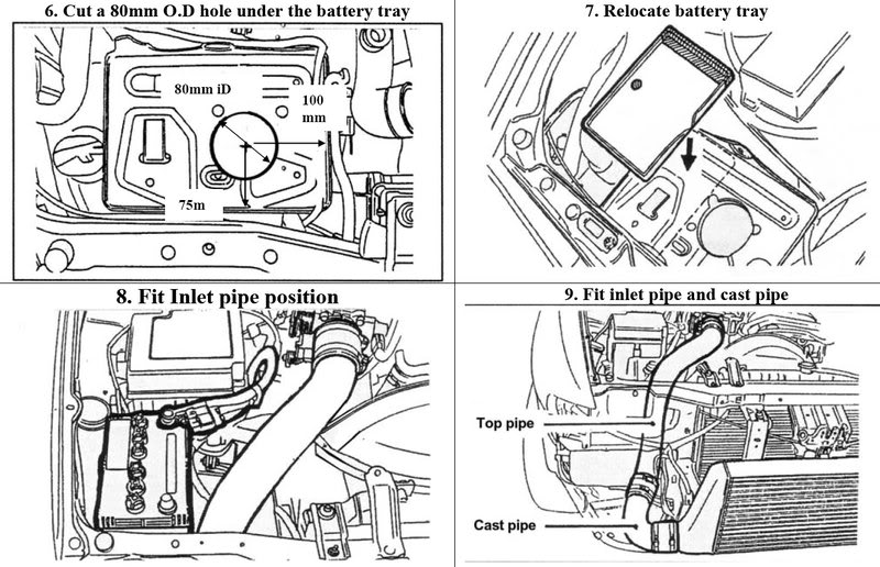

Here some pics of the way I did it, with Drill and Hammer.
Attachment 16544
Attachment 16545
Attachment 16546
I don't have any more pics from this point, but what I did next was used a file to smooth the edges. Then used 1/2 inch loom to line the hole with. The diagram below may also help.
Attachment 16547
I just registered to say WTF is that. Please don't do this people.
